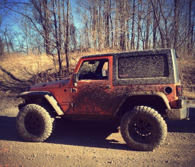

Love the 15's! IMO looks the way an offroad wheel/ tire setup should look! To each their own tho
