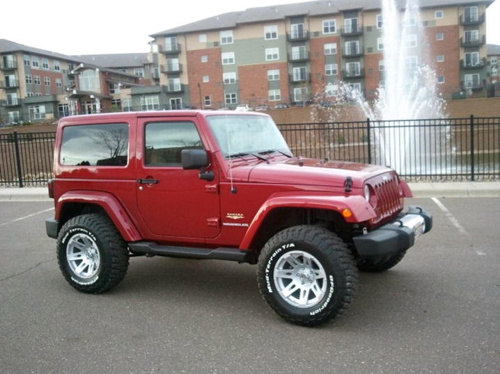

I have the leveling kit, and love it. I think the ride actually got better!
I am not a fan of painted tops but that red looks super nice!
