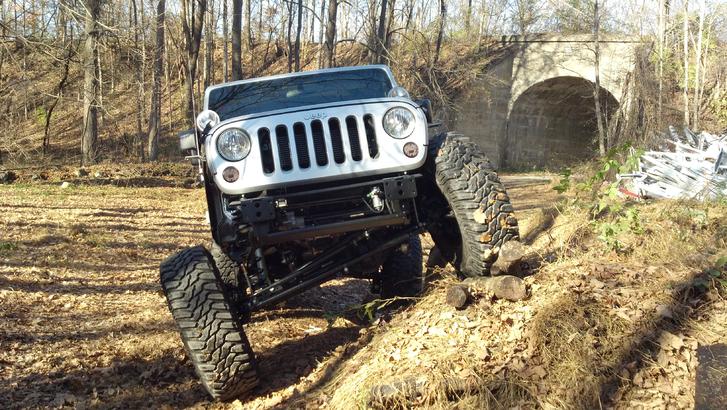

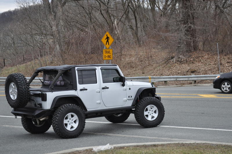

On my 09 i ran 37s on a 2.5" procomp with 3/4 spacers in the front 2.5" bumpstops front and rear. No rear swaybar front disco. Folded the hole rear pinch seam over cut 2.5" off the rubi rail and cut my factory flares. The only rubbing i had was the front tire on full turn on the the lower control arm and the drive shaft on the tranny it was an auto.

Here is my 2012 with 37s on a 2.5" Rock Krawler and a 1.25 body lift to eliminate the trimming of the rear pinch seam i had to do on my other jk cut 2.5" off rubi rail and factory cut flares. No rubbing

I got a lot of info from planmans thread.
