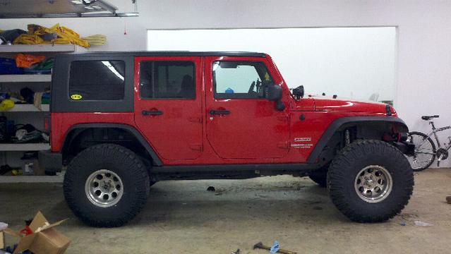

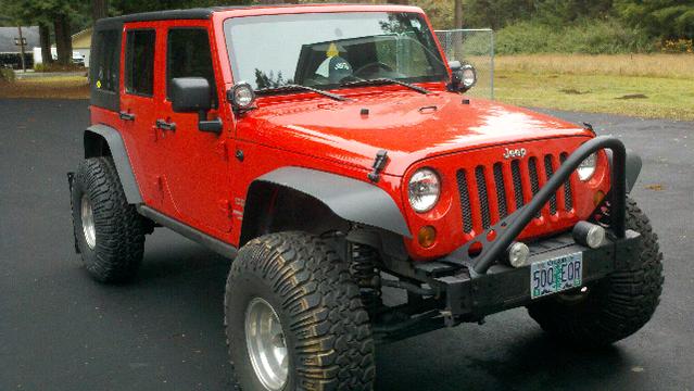

Here is Tf 2.5 coil lift and 37s.
ID:	254924   Click image for larger version
Old Dec 27, 2011 | 05:47 AM
hsacks820's Avatar
Posts: 438
From: South Jersey
what back spacing is on that wheel?? thats to wide to be legal where i live?
