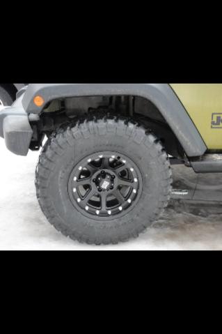

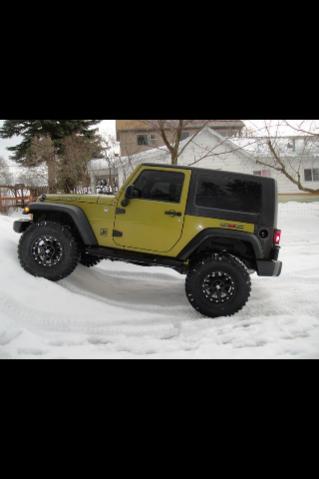

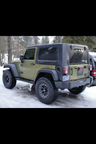

I have 35's with a 2.5 bb from teraflex. It fits just fine :-)
