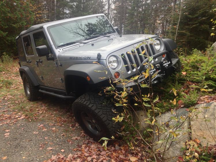

Name:	photo 3_1 (2).jpg
Originally Posted by azyjjk
I have this lift but have not gone to 35's yet. Do you have any tire rubbing on the fenders? Thinking about getting Savegre wheels.
no rubbing with AEV pintler Wheels and Duratrac 315/70R17.
