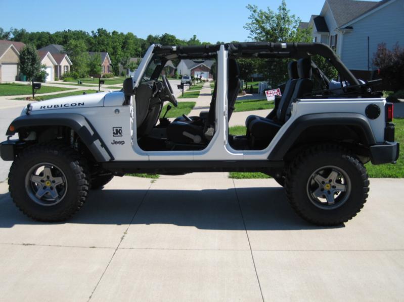

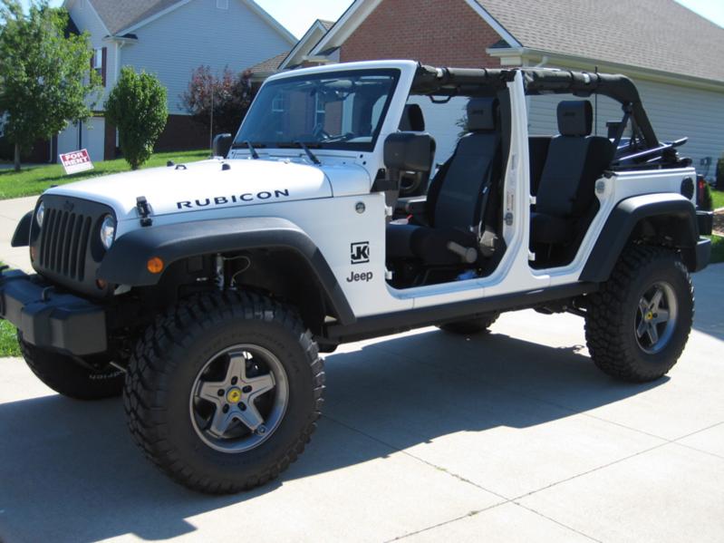

Teraflex 3 inch with 35 BFG is the way to go.
