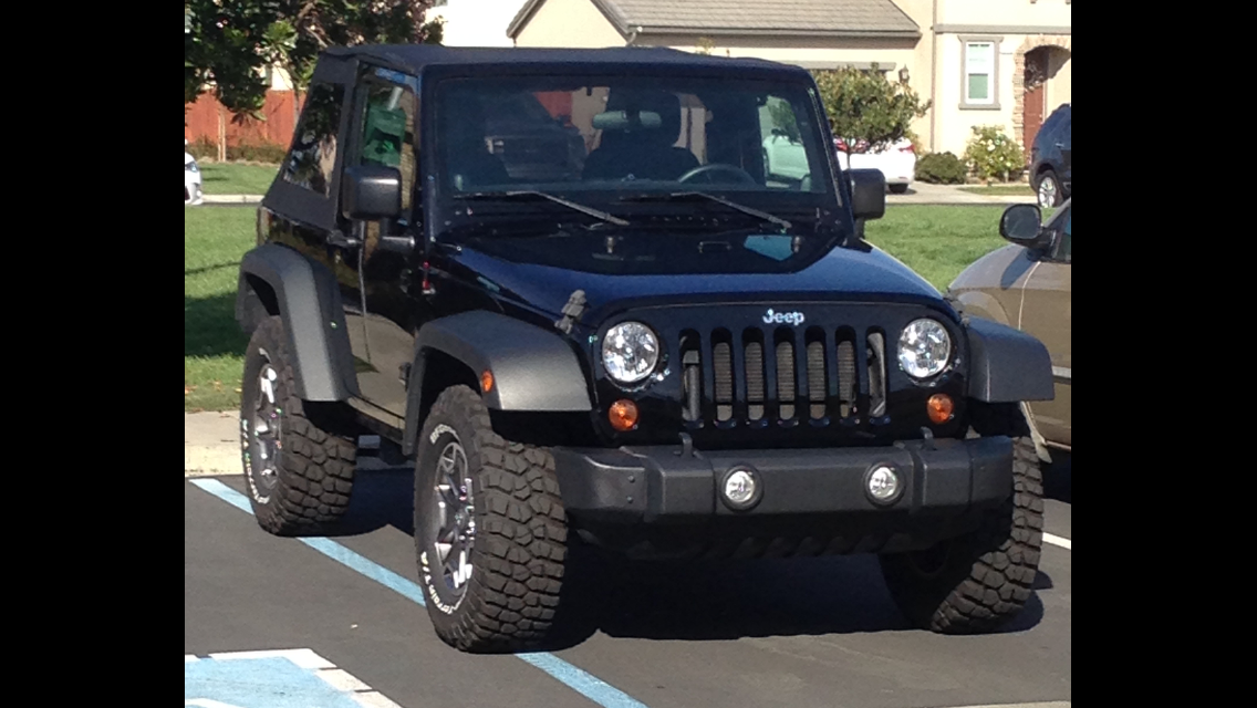

$160 basic Teraflex Leveling kit. It's basically a 2" lift. This is mine with 35" tiresClick image for larger version

Originally Posted by BFGMallTerrains
$160 basic Teraflex Leveling kit. It's basically a 2" lift. This is mine with 35" tiresAttachment 660440
Puck right? Looks good!
Their coil leveling kit is under $400. EVO's has coil in front spacers in back. TF coils are a little stiffer.
Yep, basic $160 leveling kit, Quadratec carries it. Got mine professionally installed. Comfy ride, stock shocks

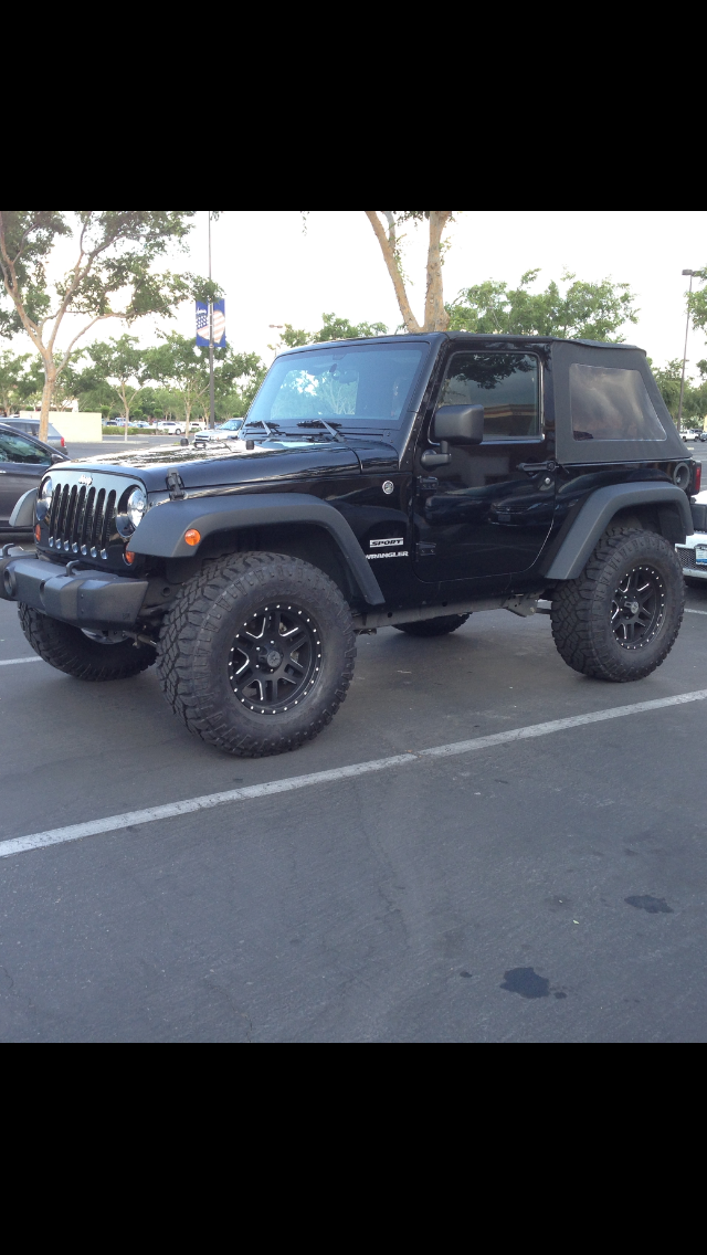

Because for increasingly massive tires, gotta have increasingly massive lift. The bigger the lift, the more "stuff" you need. This is important: If you know, way beyond a reasonable doubt, that you will never want bigger than 33" tires, then your basic Teraflex Leveling Kit, which includes a longer front link, is perfect for you. Your install shop, or you if you do it yourself, should do an alignment afterward. It's actually perfect for even mine on 315/70/17 Duratracs , see pics above, but I regeared to 4.56 to keep power. Do NOT find yourself wishing you'd gone bigger to 35's.
Here is a pic on 285/70/17 km2's before I did 315/70/17 Duratracs, level kit n gears. Duratracs would be your wisest choice, I believe, in either 285/70 or 315/70
