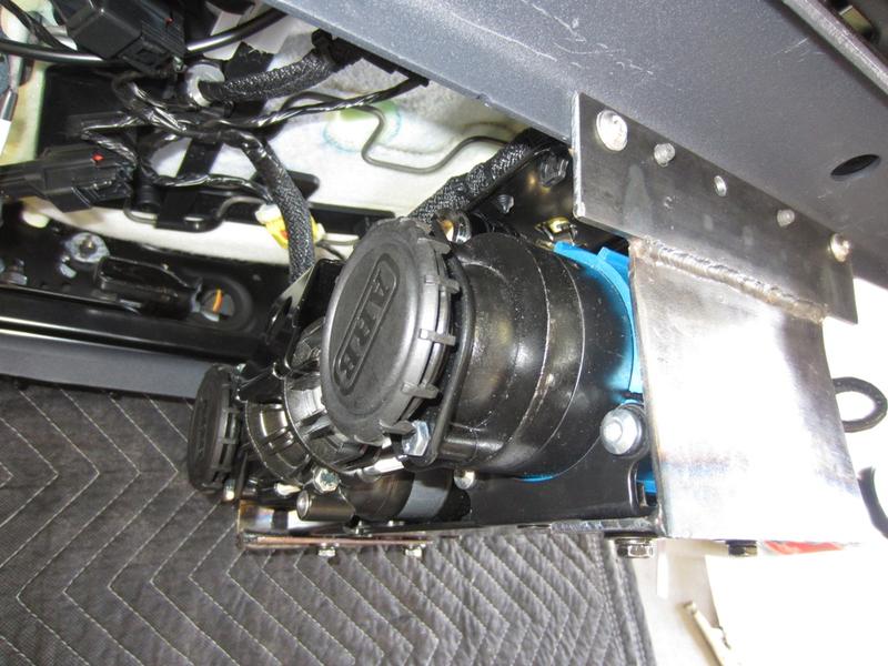

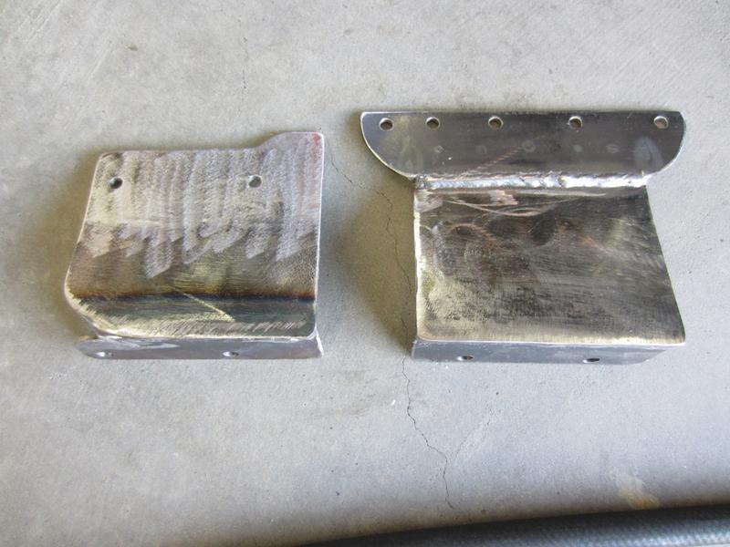

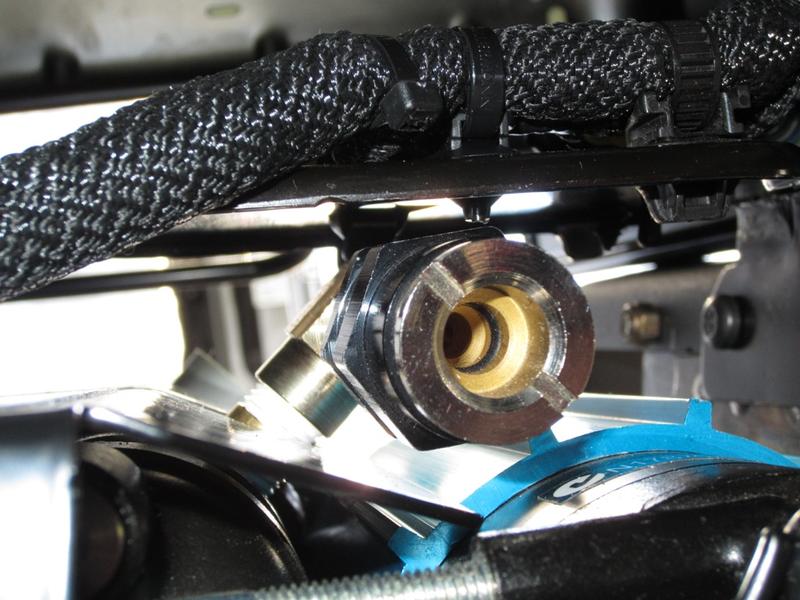

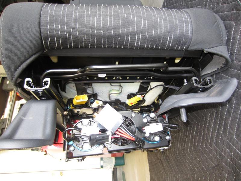

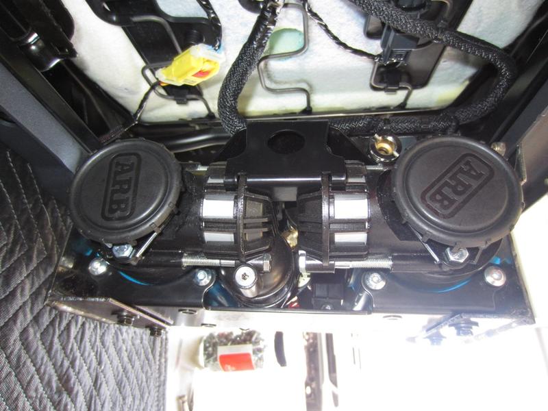

I just finished installing my ARB twin compressor. I created my own brackets and used existing holes in the seat brackets. It was a really tight fit and I had to angle the compressor a little to clear seat wires (ABS sensors & seat heater). If you notice I also notched the one bracket to clear a bump in the transmission tunnel. See pics below (before I painted the bracket black):
