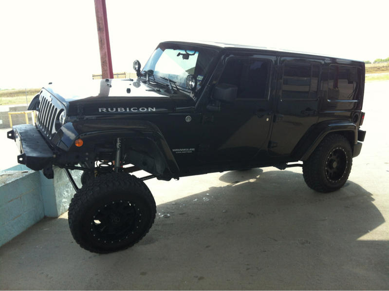

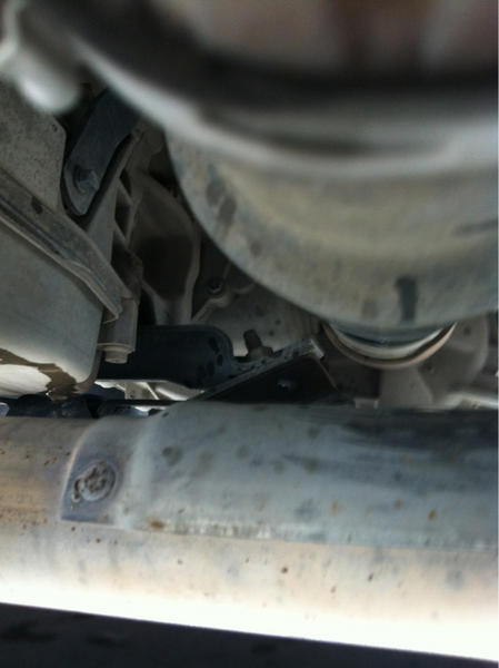

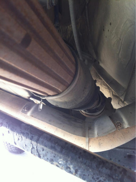

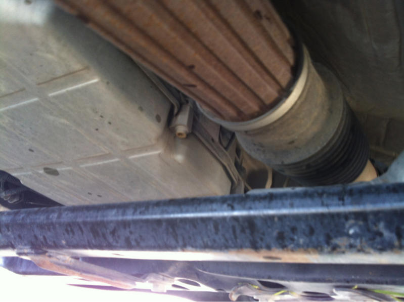

Mine doesn't hit yet. But I have the rk 3.5" max travel and got about 6 up front and 4.5 rear.
