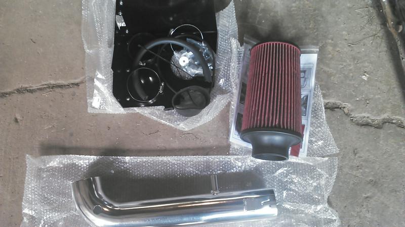

I have a Rugged Ridge air intake plus aFe throttle body and Dynomax exhaust being delivered this week and excited to install. I will post again with my thoughts on this setup soon....

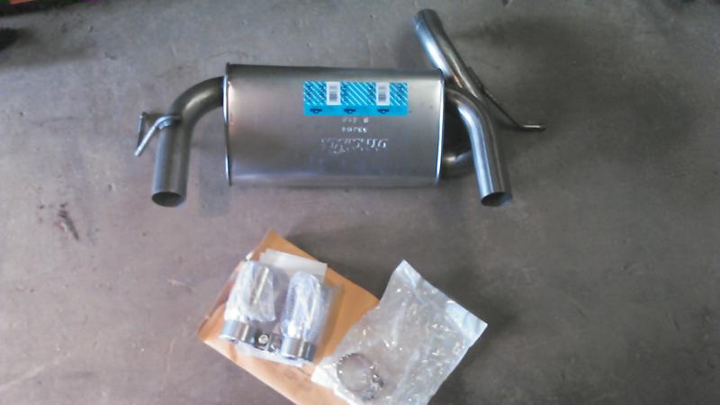

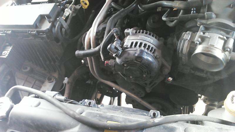

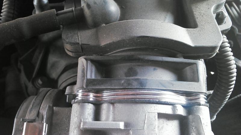

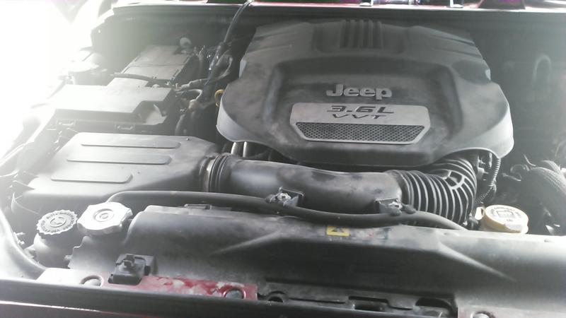

I installed the air intake, throttle body spacer and exhaust immediately after UPS delivered the parts. It took me a little over 3 and half hours mainly because the removal of the old exhaust. It took some finesse to get the air intake installed and I learned that sometimes instructions are not the best way to go. These installs were fairly easy and straight forward anyway.
I was a little concerned with the cheaper products but after my drive into work, I do have to say that I am impressed with the improved throttle response and power. I really haven't been on a long trip to see improved gas mileage as it has stayed the same. I will have to re-learn how to get the best mpg and will add to this post when I figure it out.
Overall, I am happy with this setup and I don't have any complaints. I do want to mention that I had to be creative when I reinstalled the air sensor into the new intake because there wasn't a gromit included so used the rubber mount from my old air box that I was instructed to remove. It works and is only temporary. Another bump in the road is that the Dynomax exhaust clamps are too big so I bought 21/2 inch clamp for the part that mounts together with the existing pipe and took a piece of the old clamp and placed it between the new clamp and exhaust tips which worked perfectly.
