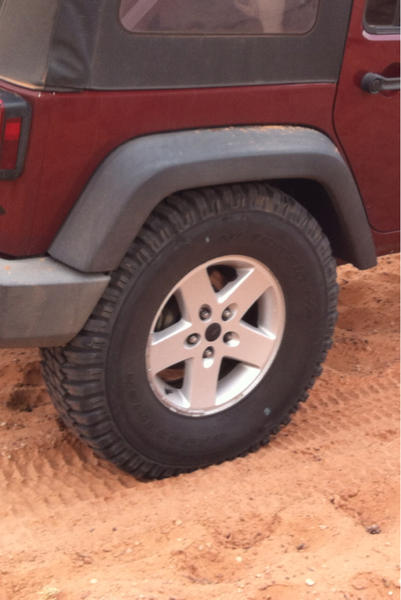

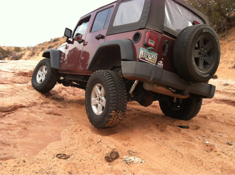

Old Sep 15, 2013 | 06:55 PM
  #56
Philip *AZ*'s Avatar
Posts: 518
From: Page, Arizona
I looked and there isnt a pinch seam in the front I could see, only in the rear. Here is how far I have stuffed my rear tire.
I have to modify my rear bumper and take out the rear inner fender liner. I hit them both and it prevents full stuff!

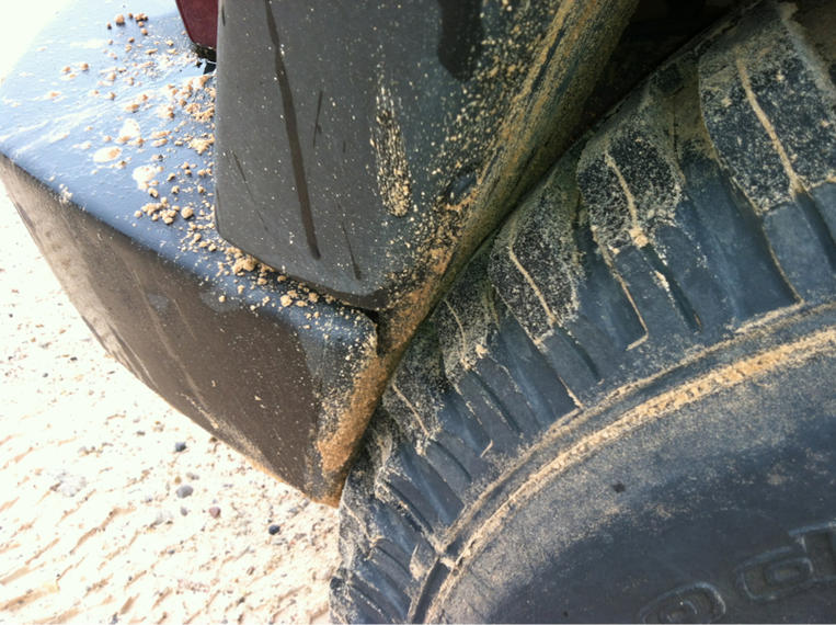

  #57
karls's Avatar
Posts: 2,873
From: 36* N
Originally Posted by Philip *AZ*
I run a 315 and dont come close to the pinch seam.
How? Do you have longer control arms in the back?? Below is a picture of 35's on stock control arms (passenger side in front of the wheel) and you can see how close the tire is to the pinch seam without even flexing it out. My thumb is on the rubi rail and the color is the pinch seam where it should be cut.
Sent from my DROID4 using Tapatalk 4
Old Sep 15, 2013 | 07:13 PM
  #58
Posts: 518
From: Page, Arizona
Oh dang Karls! Yeah that is close! I do run a Mid-Arm RockKrawler 3.5" x Factor so that could be my difference. I have probably twice to 3x the distance compared to your pic. I will shoot a pic with measurement tomorrow when the sun is up. Youre right in that pic, I would definitely trim it!
