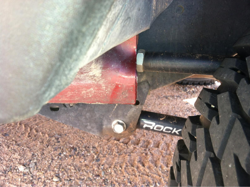

You can run 35 with no lift but you nead at least: flat fenders, trimmed air dam and pinch seams. With rear adjustable control arms you might not need to trim your pinch seams.
Rockkrawler control arms moves the rear end back 1" that is the reason you don't need to cut the pinch seam with 35. But looks like it moves too far and you hit the rear bumper when flexing.

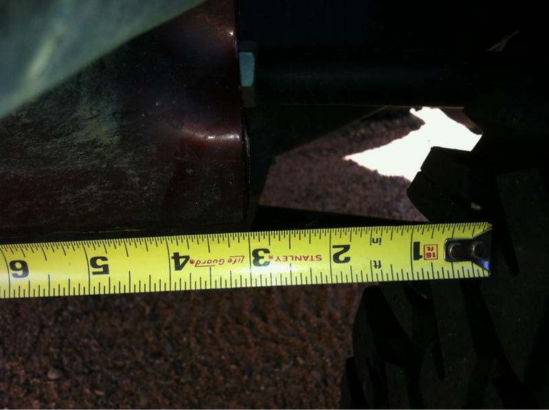

Originally Posted by karls
How? Do you have longer control arms in the back?? Below is a picture of 35's on stock control arms (passenger side in front of the wheel) and you can see how close the tire is to the pinch seam without even flexing it out. My thumb is on the rubi rail and the color is the pinch seam where it should be cut.
Sent from my DROID4 using Tapatalk 4
Here are my pics with my uncut pinch seam
ID:	498323   Click image for larger version
Old Sep 17, 2013 | 02:45 PM
  #70
Philip *AZ*'s Avatar
Posts: 518
From: Page, Arizona
I tried to get better pics, but the iPhone camera is shite when its bright outside. So I roughly have 3-just over 3in of clearance between the pinch seam. It may get cut any way. But Im in lazy mode right now and dont feel like doin anything...lol
