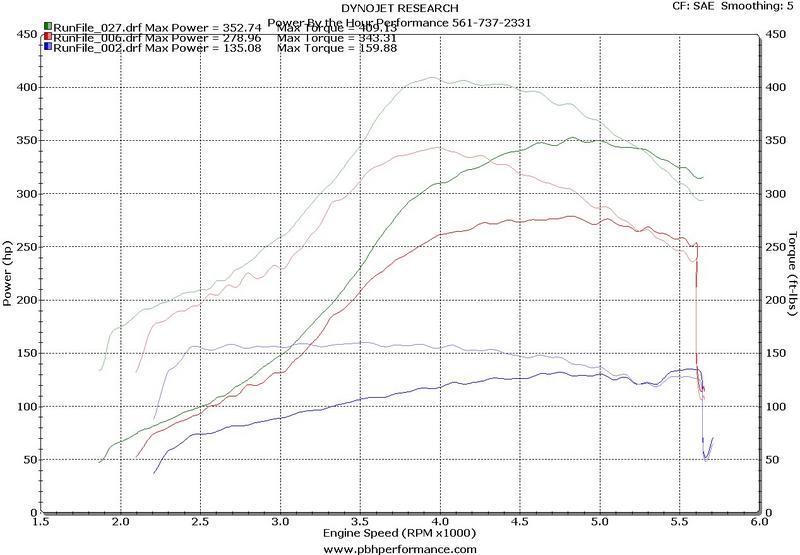

Originally Posted by ProdigyPerformance
If you are concerned about getting enough power to be worth the investment, you may want to consider an exhaust-driven supercharger (a.k.a., turbocharger). Here's dyno results of our Stage 2 (8 psi boost) and Stage 3 (12 psi boost; for manual transmission only) turbo kits compared to the stock 3.8 engine.
Attachment 642740
More power than any supercharger, with huge gains in the RPM range that really helps where the 3.8 Wrangler struggles: highway and freeway driving (passing, accelerating onto freeways, etc).

@ProdigyPerformance I have been following you guys for years and love the product! With an electronic boost controller could we prevent the turbo from spooling when we don't want it? Is the electronic boost controller something you can assist with? On the 3.8 is it possible to get the Precision Turbo vs. the Garrett to get it to spool earlier and faster?
You'd love our product even more if it was on your Jeep
In my personal experience, that question is somewhat nonsensical. The turbo requires engine load to spool. It's already sized properly so that it doesn't spool during steady cruising and light acceleration (that would cause throttle control problems, surging, excess heat from the turbo working inefficiently to produce boost across a mostly-closed throttle, etc).
I assume you are concerned about the turbo spooling while off road. With slow off-road driving, you are not putting much load on the the engine. Instead, you are getting the torque/power you need through gear ratios (torque multiplication, mechanical advantage, etc). My experience, and what has been reported by other customers as well, is that the turbo simply doesn't get in the way for slow off-road driving. It doesn't really *help* slow off-road driving either... but you shouldn't need extra power for slow off-road driving if you are geared properly, using 4LO as necessary, using low transmission gears, etc.
I personally try to keep my engine RPM no lower than 2000 RPM while driving in off-road conditions where I may need substantial power and throttle response. In the type of off-road driving I do (mild-to-moderate trails, state/national forest roads, twisty steep climbs with ruts and small steps), the turbo simply never gets in the way at all. It rarely spools, and when it does, it does so in a smooth/predictable way. With some situations, the turbo helps off road, like steep climbs where you have the opportunity to use more speed/acceleration (longer relatively smooth climbs, sand dunes, etc). It's a lot of fun for sand dune and gravel hill climbs
So long story short, I don't think any modifications are necessary to prevent the turbo from spooling "when you don't want it to".
BUT... if you really want to guarantee minimal chance of turbo spooling while off road, I would recommend running a lower boost level wastegate spring, and using a boost controller to bring the boost up to normal levels for street driving. Then you could turn the boost down for offroad driving if you wanted to. Depending on the type of boost controller, it will also help your turbo spool more quickly when you have the boost turned up for street driving.
I suggest that you try the turbo "out-of-the" box first without any modifications, though. You will likely find that it doesn't "spool when you don't want it to" already. Addign a boost controller afterward is easy enough if that's what you decide you want.
