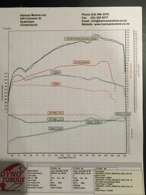

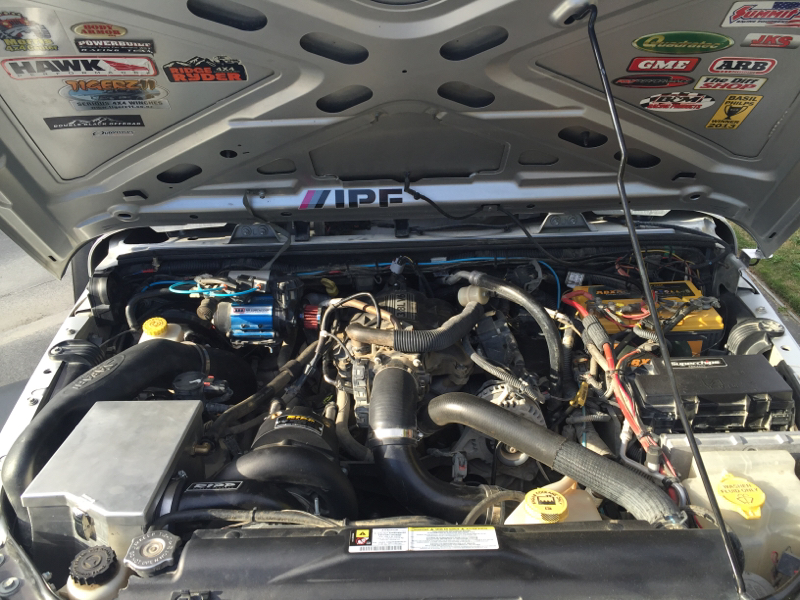

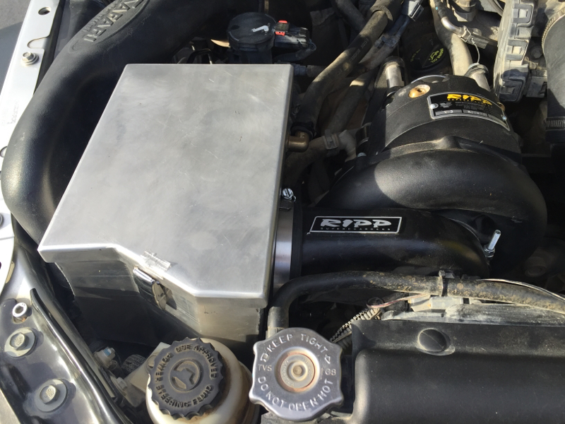

I've had my RIPP on for a few months now and am happy. Dyno'd before and after and got about a 50% gain to both hp and torque. Had a custom air box made to plumb my snorkel in but rest of install went well. Does save a bit of fuel normal driving but certainly can use more under hard acceleration. NB right hand drive

on an auto 3.8 i think drive train loss is more like 30% usually leaving about 140 to 150 hp at the wheels stock. take a look at the dyno in the previous post. its showing about 100kw stock which comes out at about 134 hp at the wheels. stock its rates 202 hp or 150kw at the crank. about a 30% drive train loss. given that only the major change in drive train in the 3.6 is the auto is seems extremely unlikely that this is enough to turn a 30% loss into 7%. something fishy indeed.
