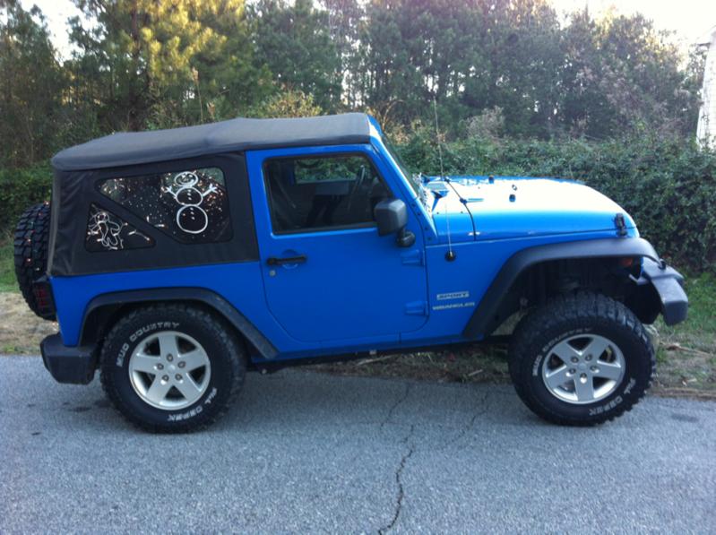

it depends on your budget and needs on and off road. if you are a serious offroader. have a lift, and some cash. buy 35's. if youre like me, and drive your jeep to school and work and only take a few trips into the mud, and have no lift, 33's all day. they will tell you at the tire shop that it wont fit but it does. 33x12.5r17 dick cepek mud country on stock wheel with 1.5 inch rugged ridge wheel spacers. they will also say the spacers are a bad idea, which they are not, they have improved my stability, taking turns with much less body roll. also 35's will have a big impact on gas mileage. NO scrub at full turning lock, no scrub at full flex. i also have the rugged ridge flat flares, they make a world of difference.
