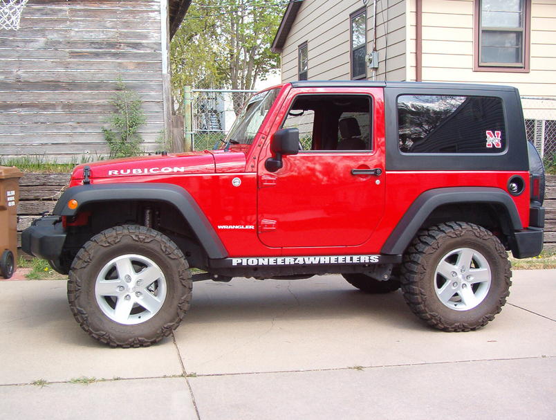

I went with 2 1/2" RC BB with 33x12.5 mud grapplers on moabs. Pretty aggressive tire and I like the look of the stock moabs.
