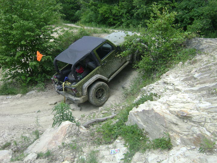

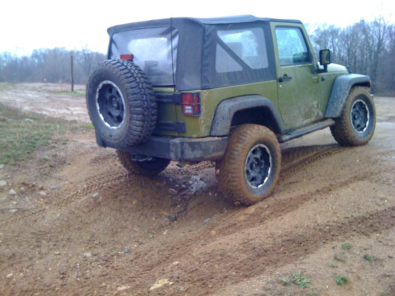

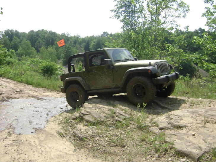

That's what I run, 34" Maxxis and 2.5RC coil lift. I have 3.73's and I use 6th when I'm on the interstate. I have been looking into regearing, but I'm not sure the cost is going to work out. I would rather get a tire carrier or other accessories with the money. In fact I think 4.10 would be just right for this, although I'm sure someone on here will tell you to go 5.13, but I think that would make 1st a granny gear. My rpm's are ~2300/2400 at 70ish mph.
