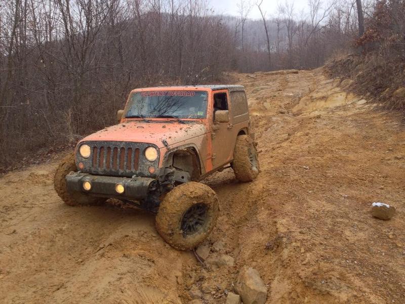

It's a lot easier than you think. 2.5" bb and 35's, no rubbing, but cut the flares cuz I like the look. Like no flares better, but too damn messy
<img src="https://www.jk-forum.com/forums/attachment.php?attachmentid=487819"/>
<img src="https://www.jk-forum.com/forums/attachment.php?attachmentid=487820"/>
<img src="https://www.jk-forum.com/forums/attachment.php?attachmentid=487821"/>
That looks sweet man, but is it really just 1/2 an inch bigger than my level? Or does it work out to be a significant height difference?

They're just coil spacers like the leveling kit, so you get what ya get. I forget tho if they're 3" front and 2" rear, or just flat 2.5"
