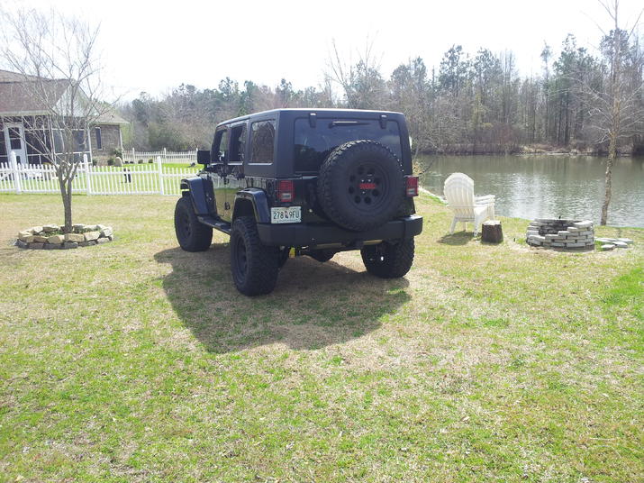

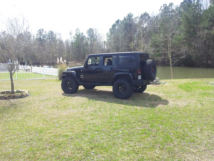

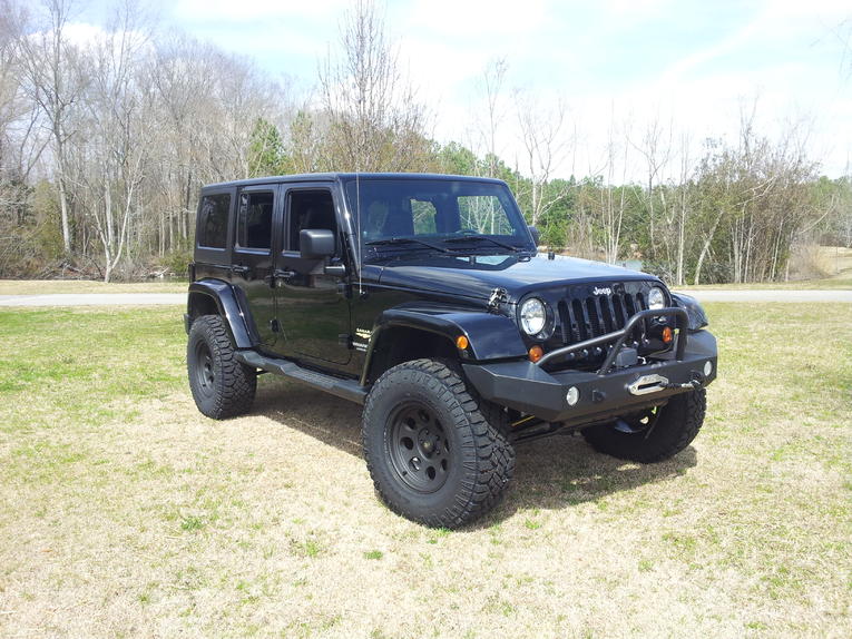

Not true ~ I have a 2012 Sahara with the 3.6 Auto and 3.21. Metal Cloak Lift, GY Dura tracs which are actually 34". Mounted is 33.75 which is what I programmed. I purchased a Flash Paq from Superchips which allows you to tune based on different octane levels. I started out with the 89 performance tune and now 93. I see a lot of folks talk negative about 3.21 and 35" without knowing all the options. I can tell you with 100% certainty it works and shifts fine. I cruise at 75 at 2200rpms. If you need more info PM and I can share my experience. Just ENSURE you update your tuner via SupClick image for larger version
ID:	600653Click image for larger version
ID:	600654Click image for larger version
ID:	600655erchips web site and by doing so, it will allow you to register and ensure you have specific year updates.
Now this doesn't mean I don't plan to re-gear, it just makes it more enjoyable to ride while I save up for my next series of mods. Which are dana 30 re-informant and re-gear
