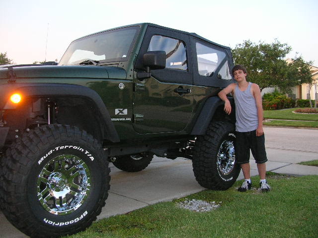

Here's mine. My son is about 5'9" in this picture.
I love the ride. Its a TF 6" LA suspension.
