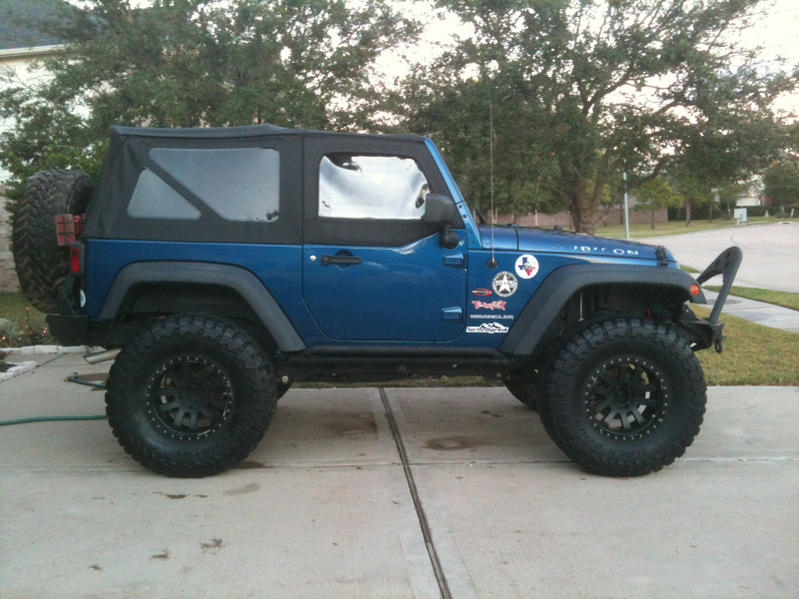

anyone have pics of their 2door with 37s. how do you like the ride?
Here is one all cleaned up after trip. I think the ride is fine. 2010 rubi 6spd, 5.38s, 37x13.5x17 Toyo MTs on 4" lift
Already replaced the rear ring once. Not sure of cause but got me thinking I want to move down to 5.13 or 4.88. It's flat here in TX and any hill I'm on I'm crawling along anyhow
