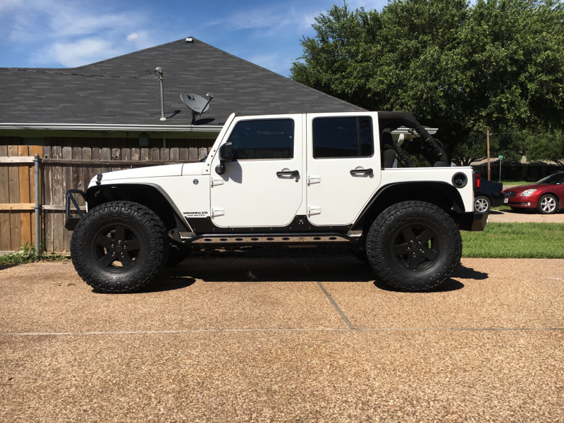

I also might mention that my jeep came with 17/59 springs. Not 18/60. I don't know how mine sits so high even with PSC bumpers and rocker knockers and side armor. All I did was take the spare off. And it is leveled 1.5" up front with coil spacers. I still consider this no lift though as I'm sure many would. Throw on some $25-50 spacers is all.

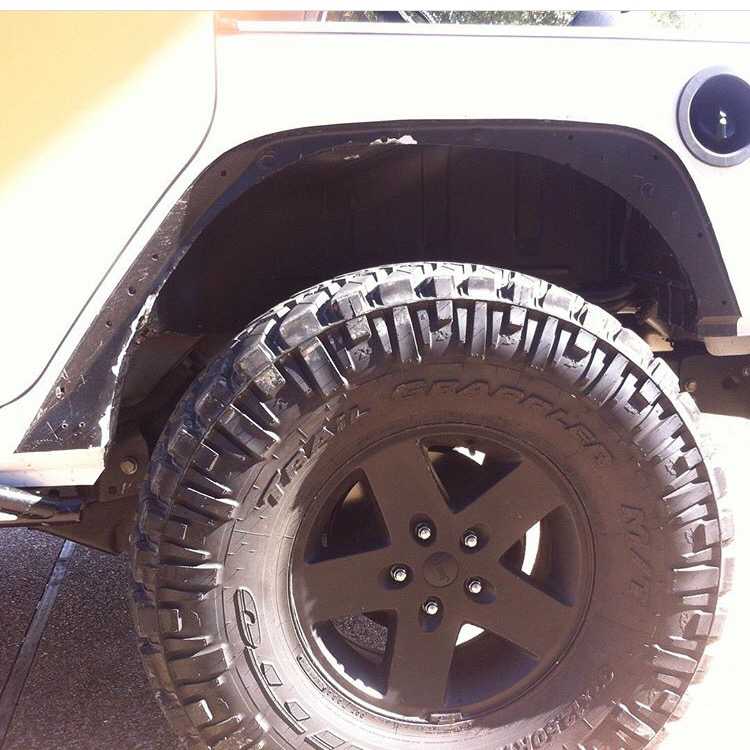

In the mean time, before I give a full detailed report, here's the stock wheel well with the virgin 37" at ride height. And here's a shot of it after I finished trimming and folding and hammering.
The only other thing I did was fold up that little half inch of seam around the back corners that pokes out under the stock flares
