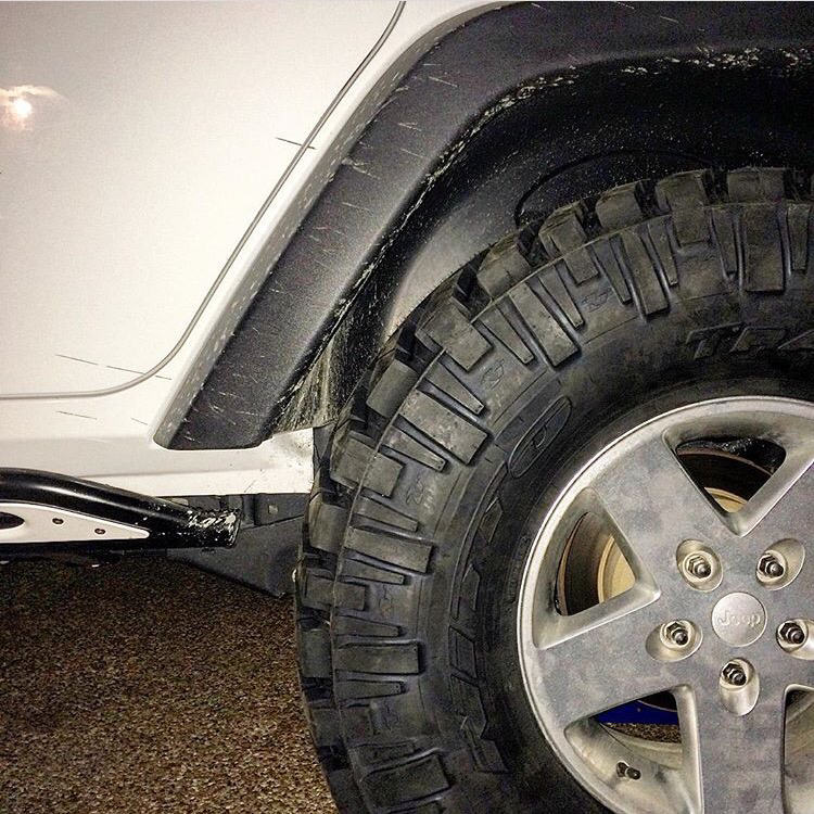

I didn't paint the edges of the shittybuilt flares because I don't care about them. They were free brand new for me and I will eventually have PSC flares.
But you can see here the notched parts and that they're flat up against the top of the wheel wells. They don't look pretty but nobody can see it unless they stick their head in between my tire and flare and look up lol. If the tire ever rubs that it just rubs, doesn't cut into the tire. My tires never rub unless I have two passengers and the hardtop on and fully flex the rear. With no passengers it has about a centimeter of clearance above the tire between the flare with fully compressed stock bumpstop. I had a shot of that but on old phone.

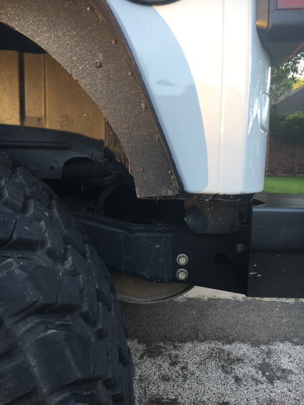

It's dirty. But that's what used to be the pinch seam with that indentation, this is an area where poison spider flares bolt to for extra support, but I sacrificed it as its not a main structural support for the flares. I made very sure that I would be able to mount them without that indentation, even if it just made them a little weaker. I won't be able to lay my jeep on my rear flares but I don't plan on that anyway. If that happens I'll have bigger issues.

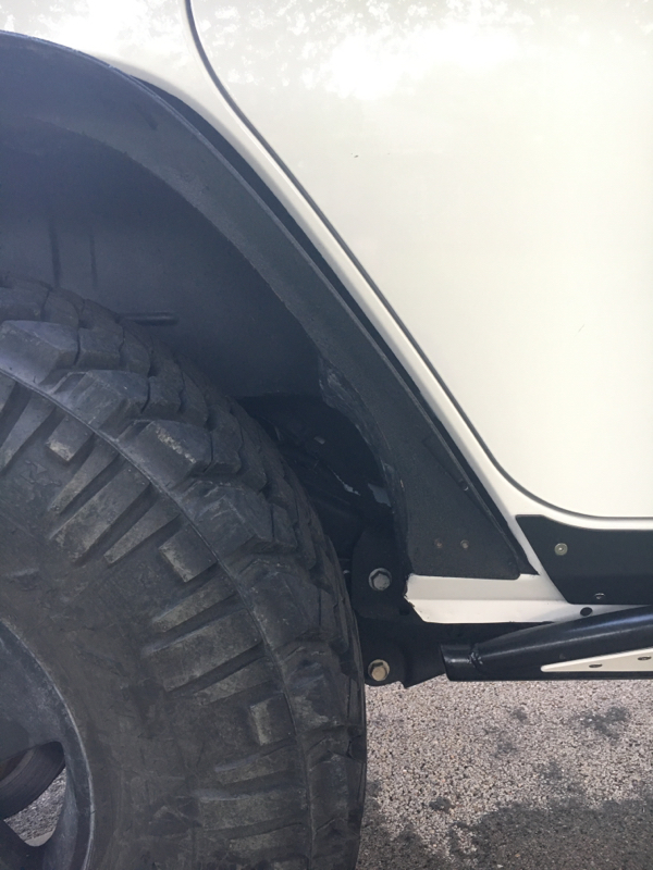

I also folded up the part around the back corners as I mentioned earlier in the thread. This gives you a little extra room in the back if you are stretched.

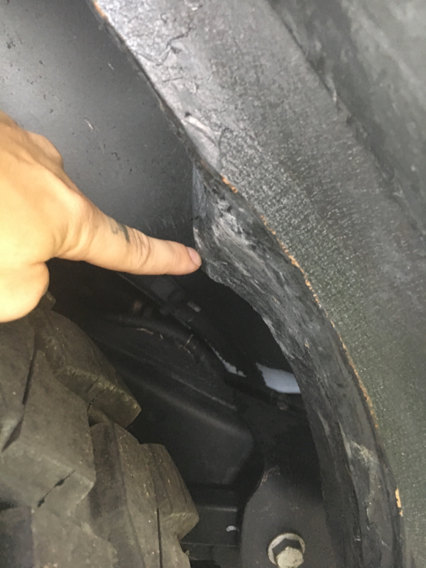

Last one. In this shot you can see some white where my tire rubbed inside there, this is where the tub protrudes into the wheel well shape, I didn't want to hammer that up or it would show from the interior with the carpet out
