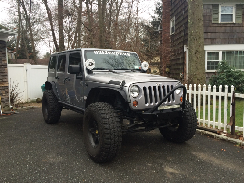

I had 2.5"lift 37s,3.6,6 speed,smittybilt flares, I had 3.73 now I have 5.13. It's not the end of the world if you don't regear right away. Just sleeve and gusset your Dana 30 and heavy duty ball joints.
