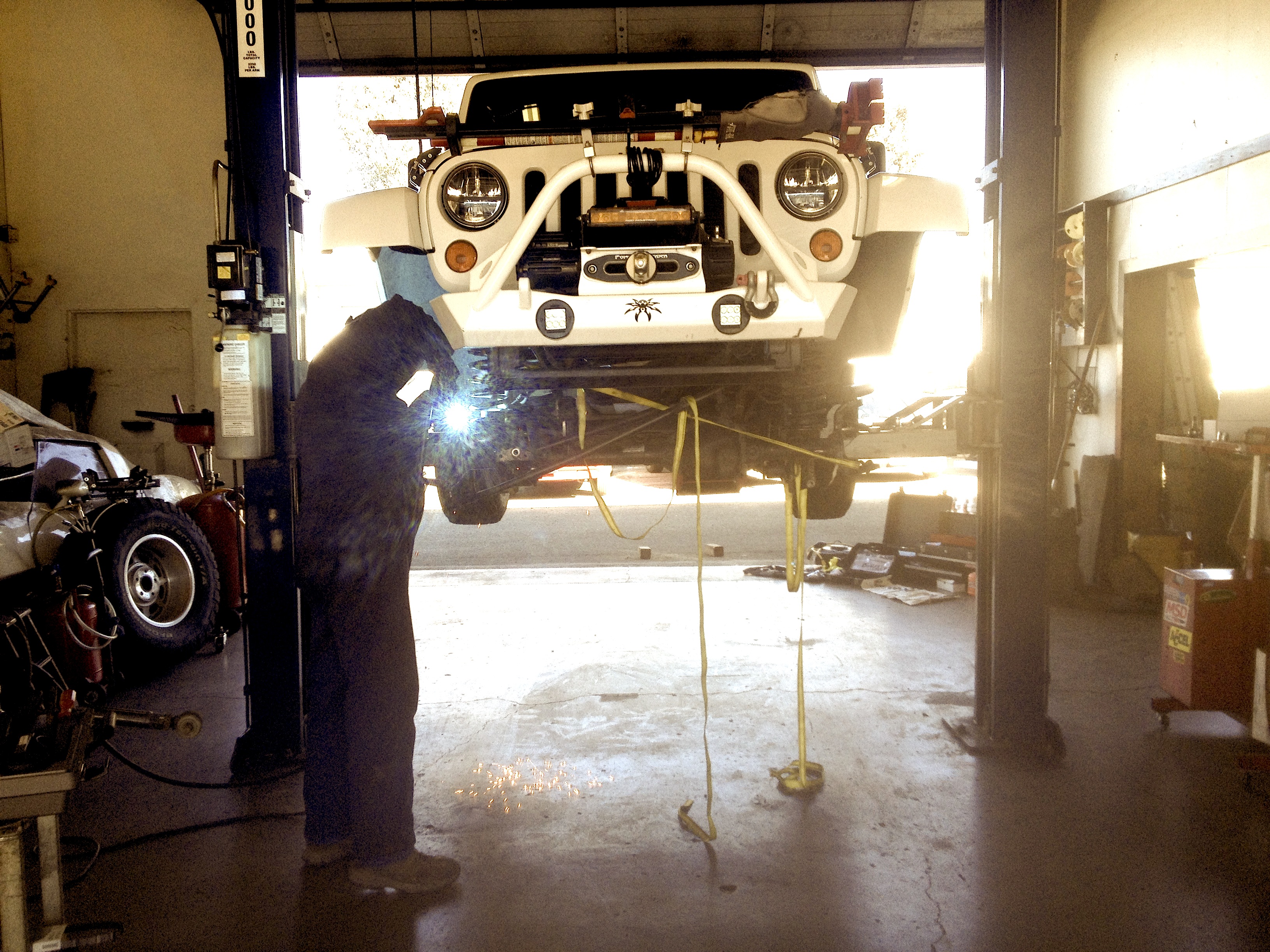

You're pretty much in the same boat I'm in with the Sahara. I'm running 35's would like to go 37 but I don't see that happening until at least the front axle gets changed out.
In the meantime, gusset your C's, slap in some Teraflex HD ball joints, and put in some Nitro sleeves (or you can go the weld-in sleeve route which btw I happen to have a set of the Teraflex versions laying around if you're interested). Throw an ARB cover or Rancho diff skid on it and you'll be fine especially since you're not doing any rock crawling. Beef up your tie-rod and trackbar at the very least if you haven't done so already.
I wouldn't bother with a front locker for the D30. Most people I know hardly ever engage the front locker unless they're wheeling in heavy snow.
Having said that, I have thought about throwing in an LSD for the front. I just have to really ask myself how realistic it will be that I change the front axle out in a couple of years. Plus I still need to regear as I'm currently on 3.73's which I'm really starting to hate with the 35's so it's probably smarter to do the regear, locker/LSD, with a stronger front axle all at the same time.
