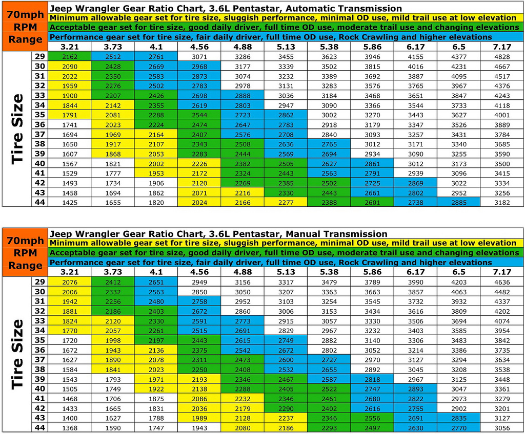

haha... yep, 5.13 would be for the 3.8L engine, 2007-2011 JKs.... 2012+ w/ the 3.6L, 4.88 is ideal.
I actually just put on 37s and can't regear for a few weeks (manual, 3.6L, w/4.10) and I have to say I was surprised that it wasn't worse than it was. It is much more driveable than I thought it would be and now I at least understand why people think it is fine. Still feels like the gearing is too high and can't wait until my regear appointment gets here.
gearing chart down by one of out members for the 3.6L engine.

I have moving around with 3.6 and 6 speed and 37" with stock 4.10 gears with no issues. I am also on no lift and Metalcloak Fenders and bumper. Clears just fine and runs okay, not a sports car.
The biggest thing I notice is the brakes... the 37" Coopers and Atx Slabs and jeep with all Metal fenders, heavier bumpers front/winch and rear and spare. Thing just seems to struggle to stop quickly.

You'll definitely need to trim your fenders or go flat. Regear w/ your year engine I'd go w/ 4.88's (had 3.21 and did 4.88). After that make sure you tune it properly otherwise it's going to feel like a dog still.
