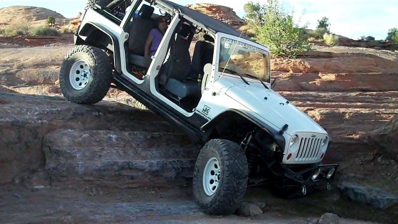

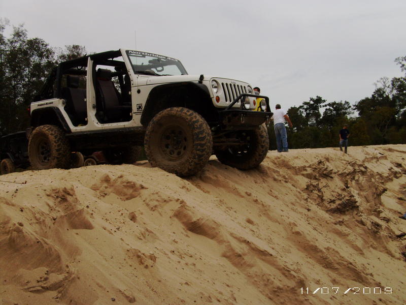

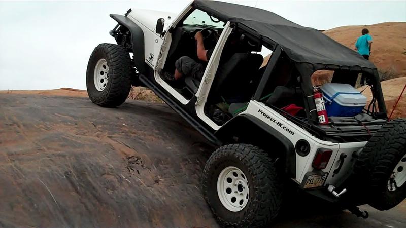

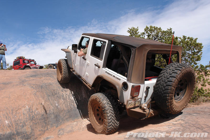

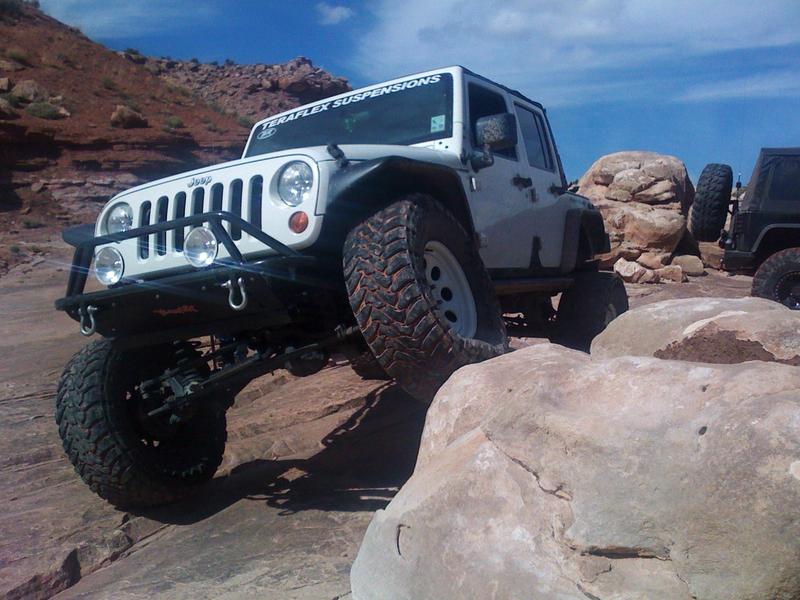

Originally Posted by rcdude3
Just get the "C" gussets and run the axle! I have been running 37's for a year now and have had no problems. There are also plenty of other guys on here running 37's on the 30 as well! I think MK Jeep has been running 37's on his 30 for like 2 years.
Yep, still kickin....

Detroit rear, lockright auto locker in front. That 15.50 tire is super wide, alot of contact area when turning and the extra weight of the rim/tire combo you want to run. It'll definately increase your chance of breaking/bending something.
Originally Posted by bubba_zenetti
How many parts have you broken so far? Curious because I see you rock crawling which we rarely get to do here in WA state. I plan on hitting Moab here in a bit and I am just curious to how your gears and axles have stood up.
I broke one axle, one ring gear (with 35s on that one) and a U joint so far but the housing is still in good shape.
Couple u-joints, ball joints, that is all.
Withstood 2 trips to moab (rocks)
Withstood 2 trips to Superlift ORVP (rocks)
Withstood several local off-road trips mostly muddy trails, alot of these were done on 35's then 37's.
I don't wheel every weekend though, so I think I abuse mine less than some on here.
