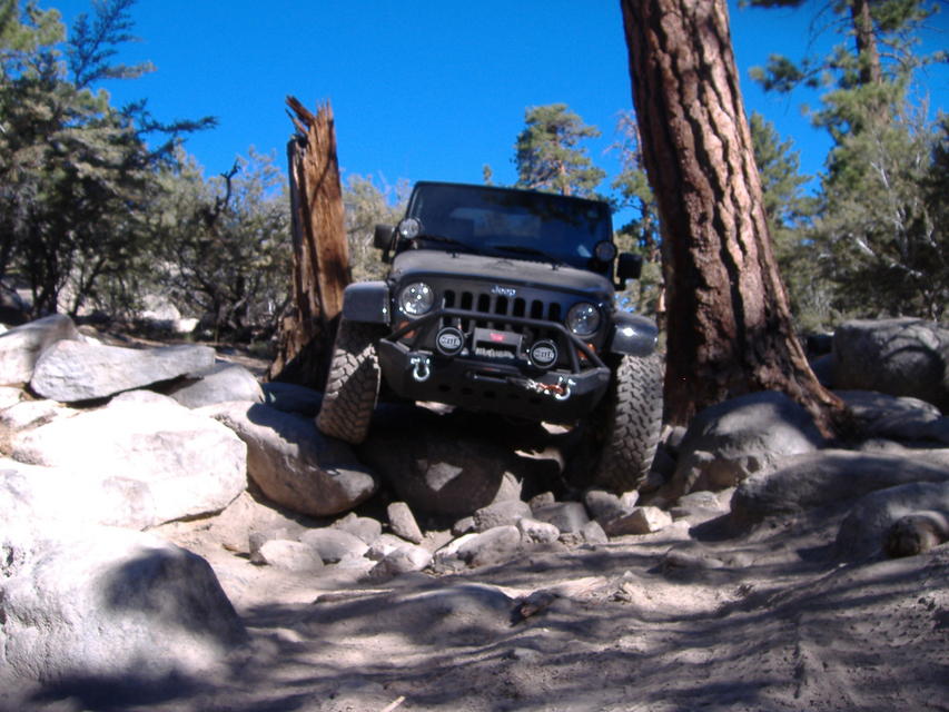

Default Off road with the 5.13,s
Well i finnally got the jeep off road with the new gearing.Totally awsome!!
What a differance,i,m running a manual 6-speed and i used to have to clutch the shit out it.
No more excessive clutching ,crawls like crazy now
