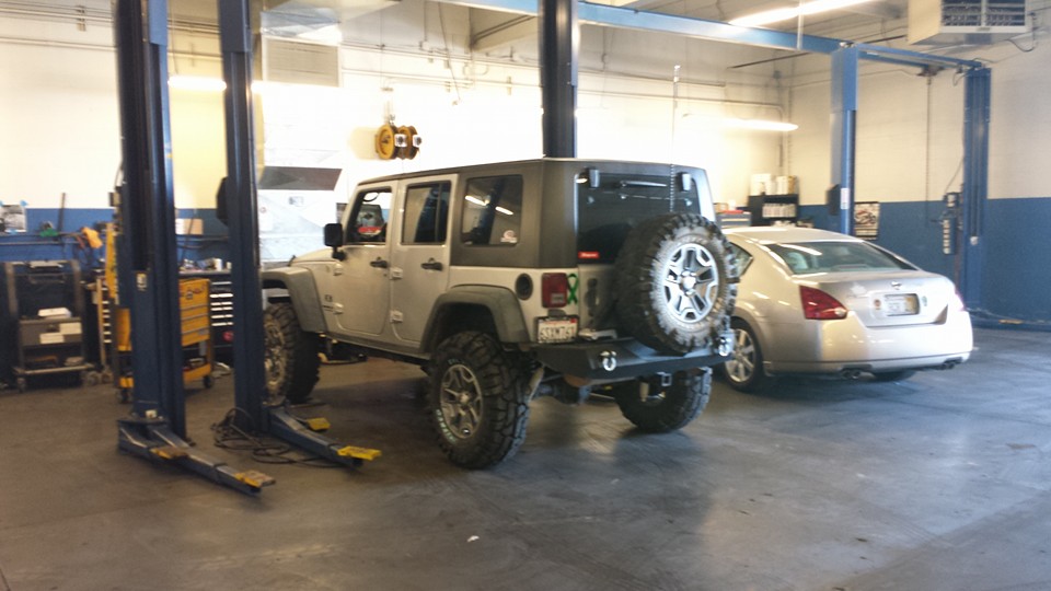

Originally Posted by kjeeper10
What shocks are you currently running ?
not sure. they came with the zone lift kit.

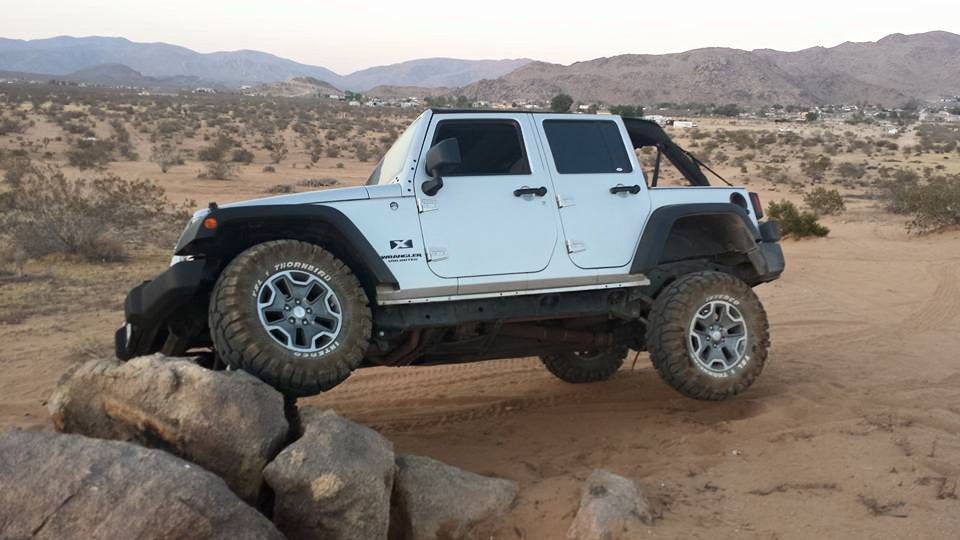

Old Dec 17, 2015 | 11:03 AM
oldmudwiser's Avatar
Joined: Dec 2015
Posts: 17
From: apple valley ca

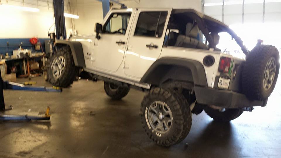

Old Dec 17, 2015 | 11:20 AM
kjeeper10's Avatar
Vet Army
Posts: 3,440
From: CT
Gotta pic on flat ground? Lift doesnt look all that tall unless it sagged.
Old Dec 17, 2015 | 11:40 AM
Joined: Dec 2015
Posts: 17
its only about 6 months old so no sag
Old Dec 17, 2015 | 11:42 AM
kjeeper10's Avatar
Vet Army
Posts: 3,440
From: CT
Ok yea pics look good. My guess is they are zone shocks.
