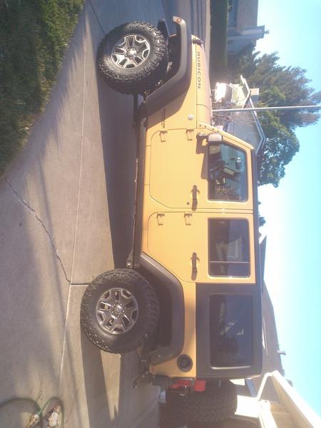

I installed the 2.5 AEV then drove it a couple of days before i installed the geo brackets, the geo brackets made a difference not a huge difference but enough to keep em installed and by the way I did a before and after measure and it is still just shy of 3" say 2 7/8 I then installed 285/75/17 Nitto MTs on stock rims with spider trax 1.5 and love them they measure 33.70 on the jeep now it is gear time thinking 4.88s.....but I am driving to Colorado/Moab this July and im thinking 2900 rpm at 70 or should i go with 4.56s I drive a 6 speed leaning towards 4.88s as it is not a daily driver simply a toy

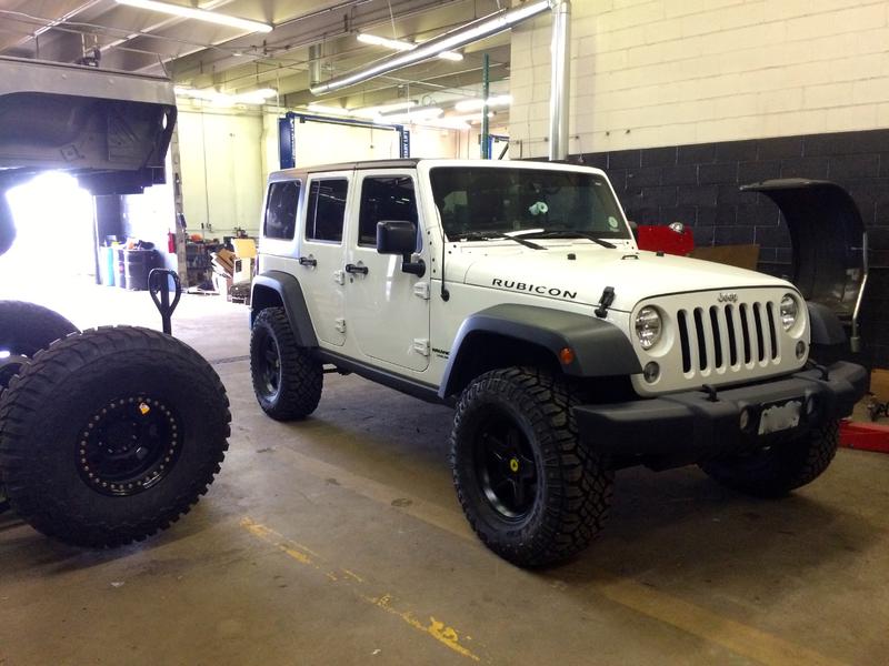

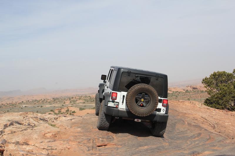

I have this same setup your looking at on my 2014. Just installed, then took it to Moab for EJS, love it, drives great and ran the trails awesome! Only difference is I went with AEV Pintlers instead of stock wheels.
AEV 2.5"
AEV Black Pintlers
GY Duratrac 315/17's
