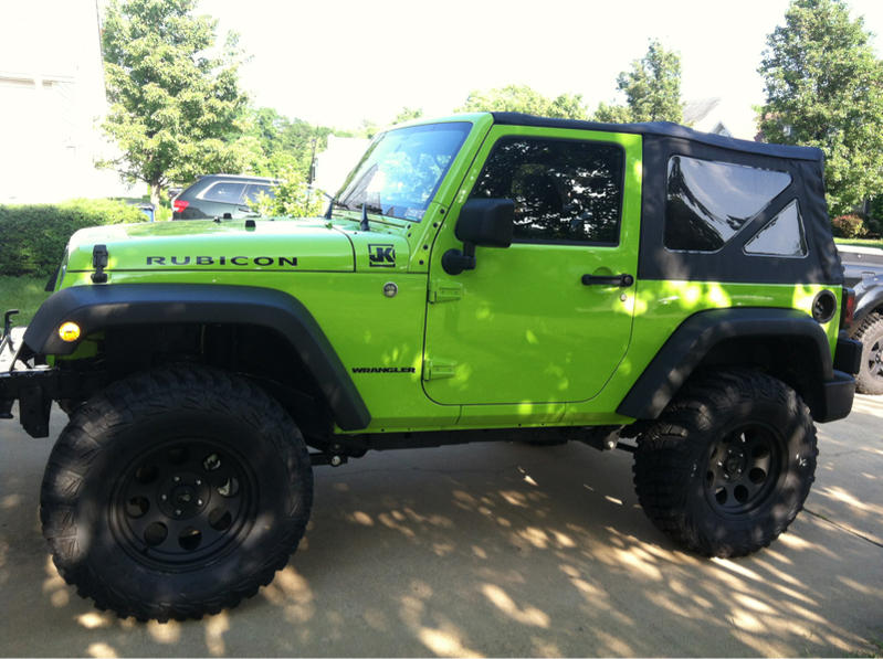

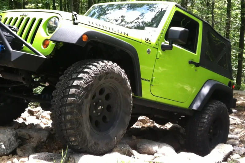

Old Jul 25, 2013 | 06:06 AM
  #26
PsychoCupcake's Avatar
Posts: 710
From: Lexington Park, MD
I'll play. Been running this lift on my 2 door for about a month now and I'm quite happy. Great on road performance and didn't do too shabby on the rocks either. Not going to win any flexing contests but works great for the weekend wheeler.
I'm running 35" Goodyear MTRs with the plan to go to flat fenders and 37s with the same lift.
Nice rig! Can't wait to see with the flatties and 37's.
