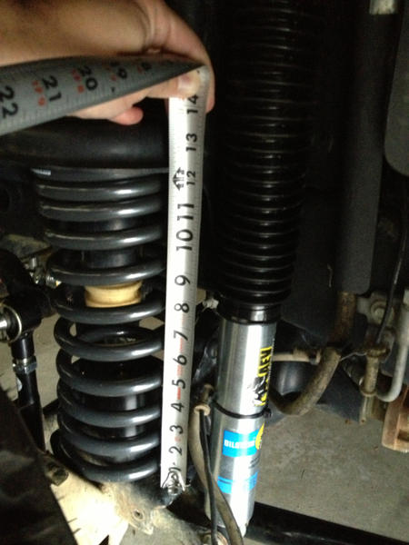

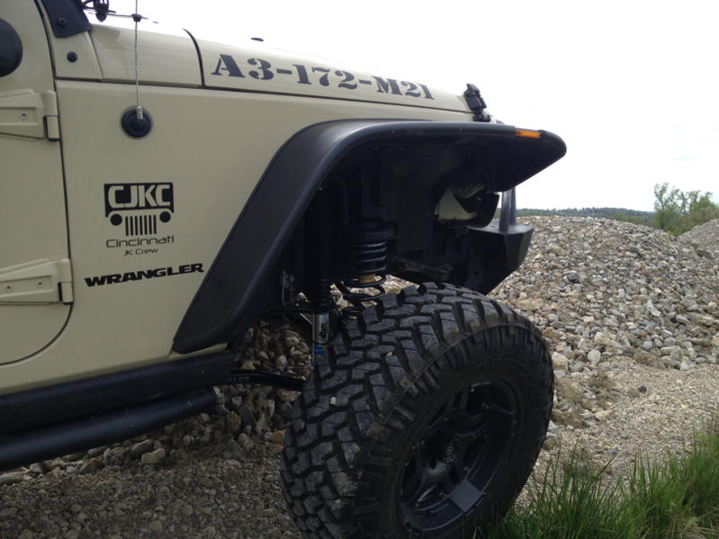

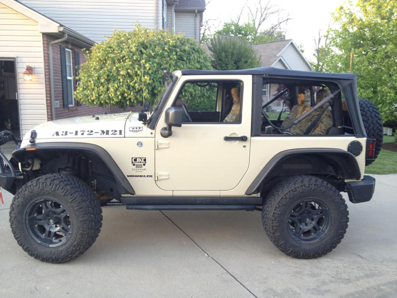

Here is my AEV 2.5 lift. Yes it does sit level. I gained an even 3" of lift measuring from the coil perch to the the lip of the coil tower over stock. Very happy with the lift, flex, and on road handling. I didn't use the drop brackets for the LCA'S. I used rock krawler LCA'S instead. My caster is set to 4.6.
