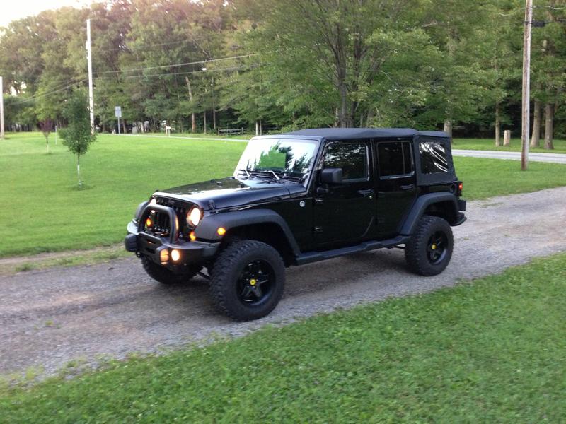

I've had mine for a few months and I'm very happy with it. Just added a few more goodies last night!
