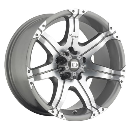

In my opinion, the AEV wheels are way overpriced for getting the same type of wheel which is made in China like every other wheel out there. Do some Googling and you will find many have had problems with the AEV wheels cracking.
I wanted something similar to OEM as well to fit my 35's. I ended up getting the Dick Cepek Gunmetal 7's. Dick Cepek is Mickey Thompson's offroad series brand name, so you should find wheel sizes made to accommodate larger tires with a lift. However, GM7's have been discontinued. I guess everyone likes black wheels now and an OEM style offroad wheel is hard to come by. I would consider looking at the Dick Cepek DC-2's to see if you like those. In my opinion, it's a better wheel at a much better price than the AEV's.
Dick Cepek DC-2's
Dick Cepek Gunmetal 7's (discontinued)

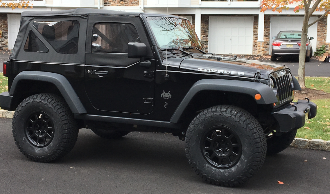

Just got Saltas with 35s with an AEV 2.5 w/geo brackets. So far it's awesome.
