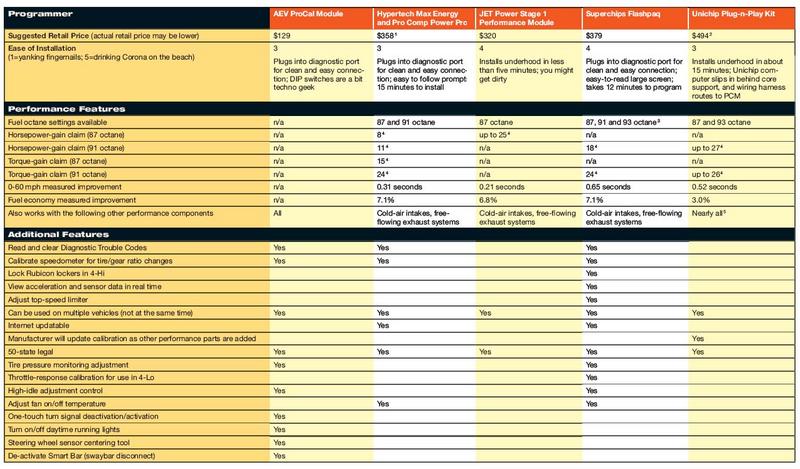

Ok, so I will be doing a bunch of mods in about a month, including 35" tires. Sorry if this has already been asked, but I have a 09 2DR Rubi 6 speed and I've been looking at the Pro Cal or Superchip flashpaq to address necessary stuff (speedo/TPMS/Gear ratio). The Pro cal allows you to get your steering dead on center, the Flashpaq doesnt. The Flashpaq has some nice features over the Pro Cal, like 4HI locker ability, throttle response in 4Low, real time sensor data, and of course the tuning.
Questions are:
-Is the flashpaq worth the extra money, especially with the 6speed (i can see greater advantages with the auto for shift point adj)?
-I like the 4HI locker ability, is there another easier/cheaper way to get that?
-Is it necessary to do the dead center steering adjustment? Can I just get this done at a dealership if I had a problem. Or maybe have someone with a procal in the area reset theirs, let me adjust my steering, reset it, and then they can have it back!?

I used the ProCal on my '07 6-speed Rubi. Biggest things I wanted were resetting the speedo and centering the steering wheel. Fairly inexpensive and did the job for me.

The main difference between the two is that the Superchips will give an increase in performance. Even with the 6 speed you still get the advanced timing of the tunes which will help, not to mention all the other features the procal doesnt have

I'm leaning towards a performance tuner (ill have to look at hypertech, i think they have updated theirs). Just want to make sure that the benifits will be worth the cost (twice that of the pro cal). My main issue is centering the steering perfectly. For those of you who haven't used the pro cal, did you have a hard time centering/was your esp light coming on ever? I heard if it was an issue, the dealership has the ability to center it?

I did this by myself when I did my lift 10 days ago, you simply adjust the drag link and center the wheel. Trial and error to get it spot on, took me about 15 minutes and 3 test drives before I was happy. right after doing the lift my ESP was on, after adjusting it's gone.
