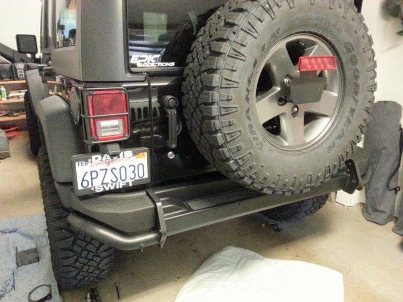

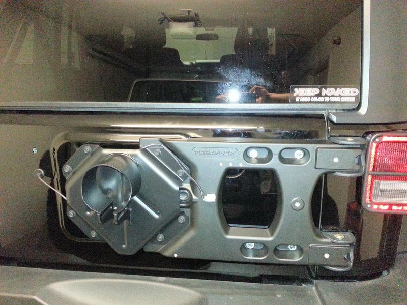

The Duchess has the AEV rear bumper and a Teraflex tire carrier which looks great together. I think there is a weight savings versus the AEV carrier and the spare opens with the tailgate still. That is a big plus if you ask me.

I think I'm leaning towards the TF as well vs. adding the AEV tire carrier. Half the cost of the AEV and I like the features (mounts in the center, not offset; lower weight; one piece opening, etc)
Attachment 391666Attachment 391667
does that CHMSL come with the TF or is that another brand?
That third brake light pictured comes with the Teraflex Tire Carrier. It uses the OE brake light. I added some LEDs and used it as a license plate holder as well.
