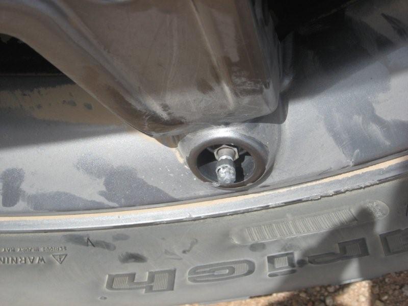

Let me start out by saying I'm an AEV fan. Now let me bash them a bit.
The AEV Pintlers have a weak point - the so-called "valve stem protector". Your TPMS (assuming you have an 2008+ vehicle) will stick out like this:
Name:	Pintler with TPMS Stem.jpg
See how they stick out? First rock or stump you come close to, they'll look like this:

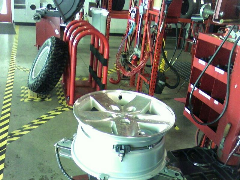

Bummer. However, there's a fix. When you have your tires installed, make sure they band the TPMS inside the tire. Discount Tire did mine like this:

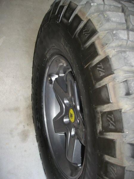

Then you can put in a shorty rubber valve stem like this:
Name:	Pintler Valve Stem Fix.jpg
Problem solved! Rugged wheels AND good looks!
