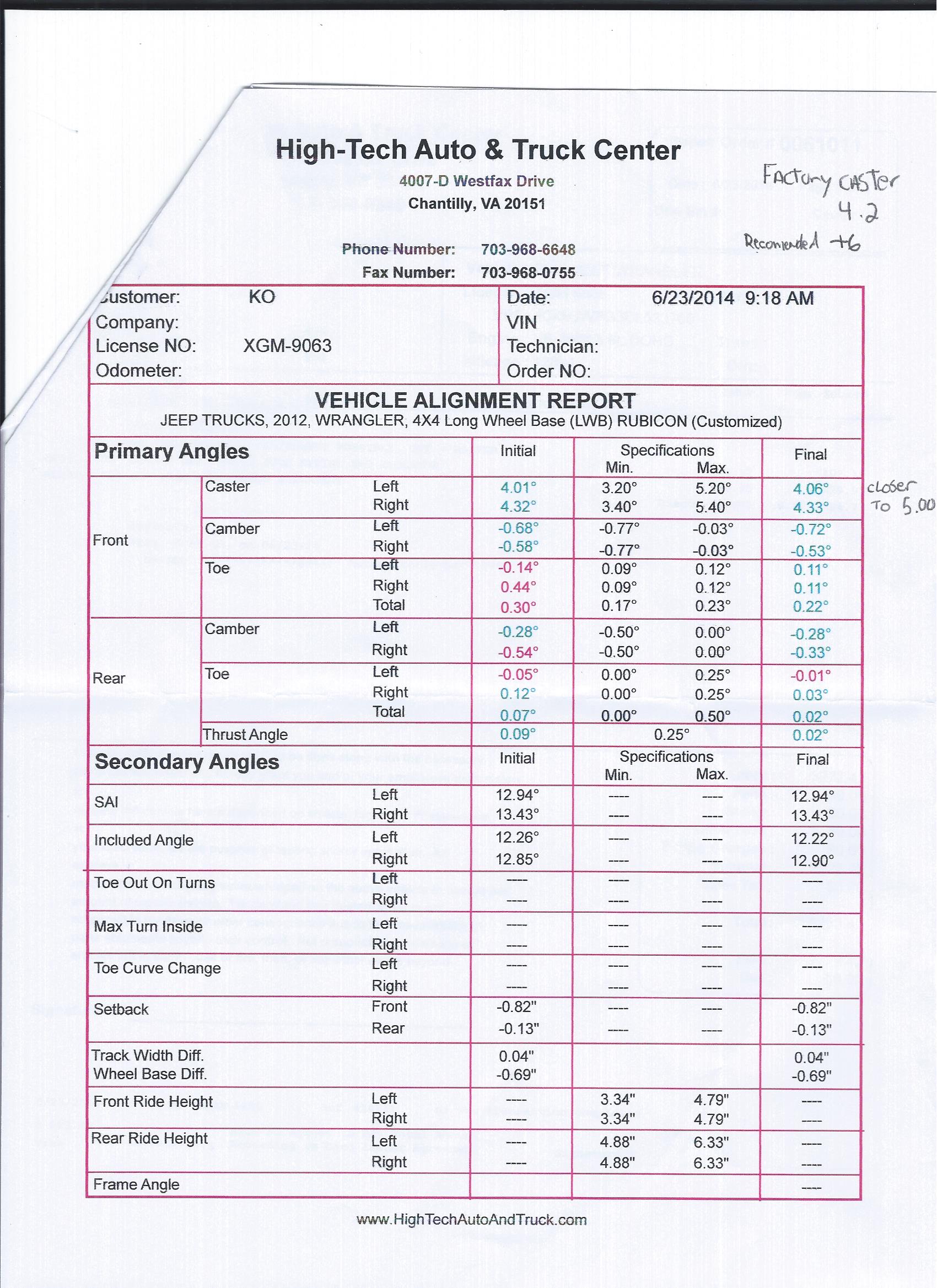

Hey guys I have a question about my caster alignment. I will be posting a pic of the alignment report in a second from my phone.
From everything that I have read so far with my 3.5" lifted JKUR my caster should be somewhere between 5* - 6* .
My question : The shop that aligned my jeep has the left caster at 4.06 and the right at 4.33, is 0.27* degrees off from left to right acceptable?
Should I be looking for a new shop?
What is an acceptable difference in caster from left to right?
Is there anything else on this alignment report that i need to address?
Thanks!

Most alignment shops will set you to stock specs - unless you tell them otherwise. Others on here have reported that it is not uncommon to have different caster settings to account for the crown in most roads.
Instead of looking solely at the numbers, drive it. How does it handle? Any wandering or pulling or bumpsteer?
It is also good to remember that as you raise the caster, the pinion rotates down, which makes the driveshaft joints work at steeper angles, which, at some point, can cause driveline vibes or lead to the joints spitting out all their grease and failing. So don't raise the caster just to hit some magic number you saw reported. Base it off of how 'your' jeep drives.

Yes, I am worried about the pinion angle. I just bought this jeep exactly the way it sits currently, The last owner had this lift installed this alignment done.
I have owned it for about 3 weeks now.
The reason I am looking into the alignment now is because the jeep is pulling to the left at interstate speed, slight wandering it also has moderate bump steer.
Just trying to hopefully find a happy medium between caster and pinion angle.

If you increase caster, it will make the onion angle worse. However, you will find that the Jeep drives better at around 5 degrees. Given that you are not driving in 4wd, the pinion angle will be fine at that level of caster.
As for the bump steer, that is the result of the angle on the drag link. The tricky thing about lifts is that the actual lift height always differs from what was advertised. It has to do mostly with the weight of the vehicle, and a lighter vehicle will end up with more lift height. It is likely that you need a drag link flip and raised tracker bar bracket to correct the bump steer.
The pulling on the highway could be many things, including the tires, the steering stabilizer, etc. Less likely the alignment. Some steering stabilizers are charged and have a tendency to push the Jeep left. Try unbolting the stabilizer and see if that changes anything. Another thing to try is rotating the tires to see if that changes anything. If not, you can modify the caster to it helps the Jeep to track the way you want it to. It is not uncommon to have different caster between sides as it can help offset the crown found in most roads. Too much of a good thing is also bad.

If there are no other issues with your Jeep, then you can adjust the caster on one side. A vehicle will tend to pull to the side that has less caster. So, either increase the caster on the driver side a little or reduce it on the passenger side. There is nothing wrong with being .5 degrees different side to side if the Jeep is driving straight. Another thing is where caster is at. With a lifted JK, not enough (such as running stock caster) will cause steering to be slightly and cause the Jeep to want to wander. Too much can have issues as well, but that would be hard to do on a JK.
