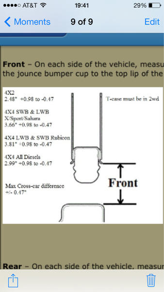

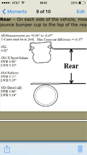

Use the measurements in the attachments to see exactly how much lift you currently have.

Thanks for the picture, I'll post my measurements when I get home.
