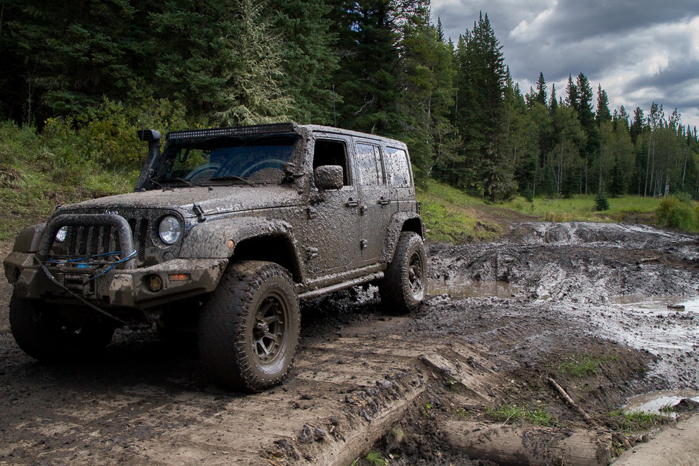

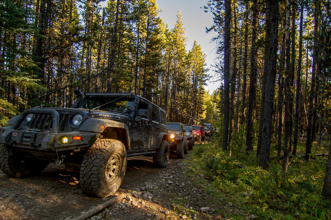

Wow, no kidding then. Zone told me it looks like their 4" lift from the pictures and the Jeep really doesn't look 2.5" taller then yours.
I don't have any side pictures but this is it from an angle at least. The rear fenders are trimmed as well so it might 'look' taller but its really not. Definitely have it lower in the rear.

Good pics none the less.. and the only reason I suggested the sway drops.. was that if one added the spacers.. the sway may be off slightly.. the blocks would bring the sway back to a more relative location.. But adding the spacers on these coils.. may just make them bow more.. Yet I see others say sag.. I'f it was sagging.. The coils would sag or droop.. in his image the coils are being forced to bow.. which could indicate weight or otherwise.. which is what we are attempting to determine.. would adding new coils correct this?.. maybe.. But what about adding coil overs.. the shocks within the coils.. that for sure would limit the bowing effect.. But I'm under the assumption that it's just the front that's bowing and not the back.. is this true?
