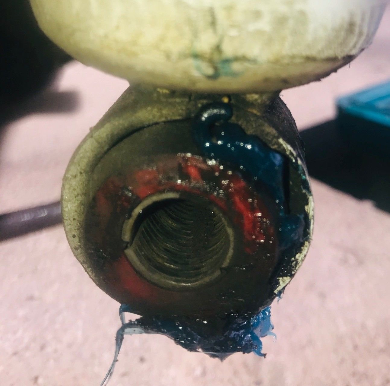

right side rear shock, the squeaky one.......... next up the left side/non squeary bolts are the same size........ blue stuff is marine grade grease from my boat that I tried in hopes of getting rid of the squeark
