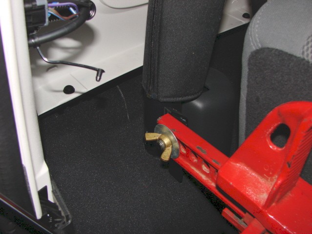

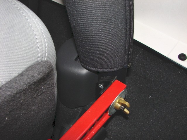

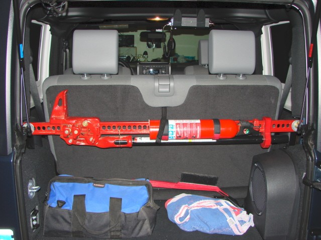

I mounted this jack in my TJ 3 years ago the same way - sold the TJ and recycled the brackets, jack, and fire bottle. The roll bar is about 1" wider at the base so I had to make some spacers from some hardwood I had in the garage. Any mild steel or aluminum with a 90 degree bend and sufficient width will work. When I take the top off, I just use a cable lock to make sure the jack doesn't run off. Hopefully the pictures work - first time posting pics here.
