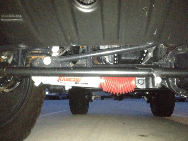

I'm looking for a picture of the setup. I followed directions to a T (I thought) but I have some rubbing going on. Can anyone snag me a photo of their Rancho stabilizer?
P.s. I'm talking about the regular, single one (not high clearance). I think it's the RS5000 (Part no. RS-5407)

I have a RS5418, give me a bit and I'll go snap a pick for you

Ok here is my setup....
