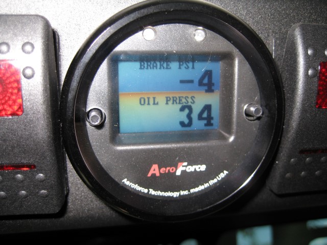

Originally Posted by GoBig
Just run aeroforce gauge (s)...I do and it reads oil pressure on my 2012.
x2. And much, much more.
Name:	BBK 025 (Small).JPG

Oh cool, that would totally work. Thanks guys!
14Sport, did you use the 9' cable? Looks like yours is above the windshield which is where I would be putting mine. Unless it only has just a couple wires that can be spliced to extend.
Old Aug 30, 2014 | 07:26 AM
14Sport's Avatar
Joined: Nov 2013
Posts: 3,703
Likes: 8
From: The Dirty South
Yeah I got the long cord and just looped excess under the dash.
