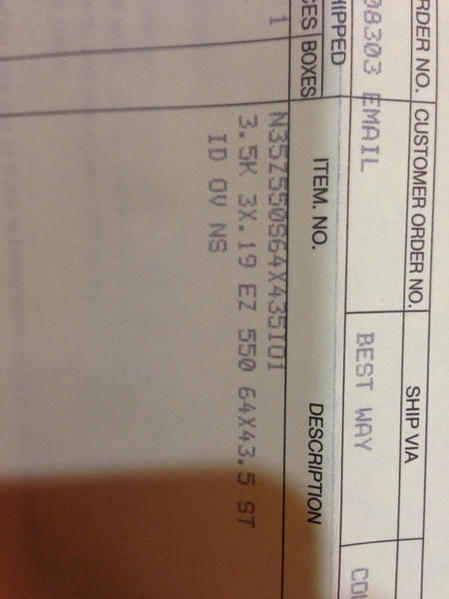

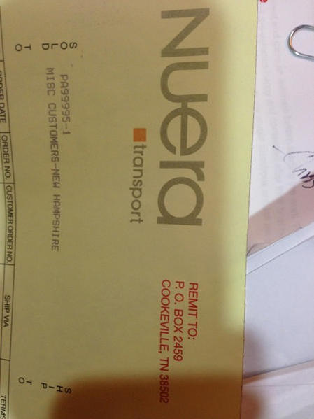

Here was my bill with specs.
ID:	456931   Click image for larger version

When i ordered my axle from dexter I ordered a 3" tube with 5x5 spindles. HF= 61" (should have done 62/63) SC=43.25"
on the m101a1 stock axle you can cut off the shock mount/ubolt and you can reuse them if need be. I cut mine off and had new u bolts made up at the local spring shop. Also if you plan on using stock Jk rims you have to order up some 2" spacers to clear the dust cap.
Thanks for the 1st hand knowledge! Will be visiting the Dexter Axle site as well as looking at spacers
Thanks for the info, as this will help me with the direction of choosing a direct,almost, drop-in axle
