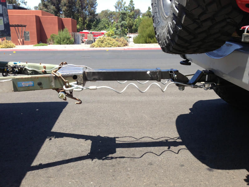

Have you thought about the hitch that swivels, so the trailer can lean any which way independently of the truck?
Yes, purchased and installed. Need to get welded on the safety chain bracket and the bracket for the swing away jack. Click image for larger version

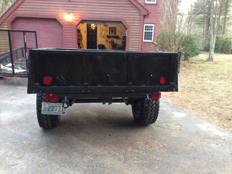

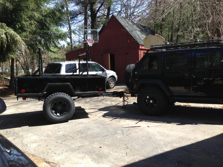

I kept the pintle hitch for more flexibility. I have no clanking at all. It depends on what hitch you buy. The multi purpose hitch, with the ball, has clanking issue. I bought hitch that is pintle only. As for lights, conversion is easy but I just stripped entire system and harness and added new lights. Saved on weight and looks good. I compared the old army lights and new ones and liked the look of new better. By adding matching wheels to trailer you solve the height issue. I have 35s on jeep and trailer and as result the trailer is more level.

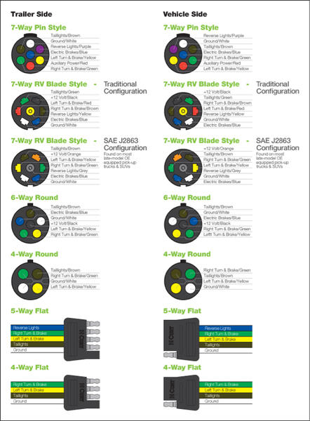

For the 4 wire setup I did the following:
Purchased 2x 1156 & 2x 97 bulbs was less than $10 for all.
22-461 = left stop/signal. 22-460 = right stop/signal. 21 running/tail light. Screw the ground to the frame.
