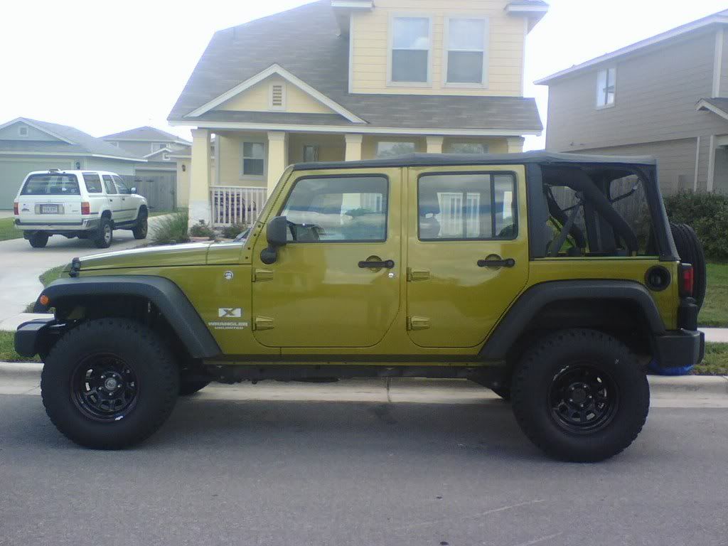

So long story short...Last week I leave my Unlimited X with the wife to go get the 12,000 mile check up done at the dealership. She says its going to take a couple of days. So on Friday she pulls up and she had the dealership install a Teraflex 2.5" budget boost, 33" BFG AT's and some aftermarket steel wheels. After my initial elation and test drive, I started looking around and the tires stick out on the passenger side 1" in the front and 1/2" in the back. They are flush with the fender flares on the drivers side. I don't know anything about this stuff but what I have read here and one other place so I am sure you can all set me straight.
Is this a problem? I have read around and it looks like the axle shifting is normal but it seems like a lot to me. Its the first thing you notice when you are standing in front/behind. I am becoming more paranoid each day I drive. Do you think the dealership didn't put the brackets for the Trackbars on correctly? Switched them up? From my ignorant perspective, the axle should have shifted to the drivers side with the lift, not the passenger side. Correct? Incorrect?
I think you all see where I am going with this. I don't know if I have a real problem and if I do how to fix it.
drivers side:
passenger side:

Here is a picture of the front. It doesn't look right to me:

that trac bar braket goes in the rear
and at the frame mount

i believe they have the rear track bar mount on the front. that bracket looks like the one that bolts to the frame mount on the factory track bar imo. send some pics to tera flex they will help, but that doenst look right to me. do you have a relocator mount on the rear ?

i have to agree with everyone else - that bracket does not belong there and your jeep would be dangerous to drive in this state. so you know, getting rid of the bracket will help correct your axle shift a bit but it will still be off until you can install an adjustable unit.
