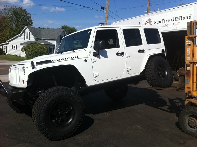

this one is before flats and it would rub, after i installed the flats no problem.
ID:	410750Click image for larger version
