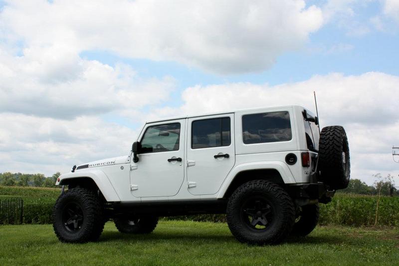

Originally Posted by 1LuckyJK
this one is before flats and it would rub, after i installed the flats no problem.
Attachment 410750Attachment 410751
What brand are ur flat fenders?
Old Jan 18, 2013 | 07:46 AM
1LuckyJK's Avatar
Posts: 439
From: Palm Harbor, FL
Poison spyder
